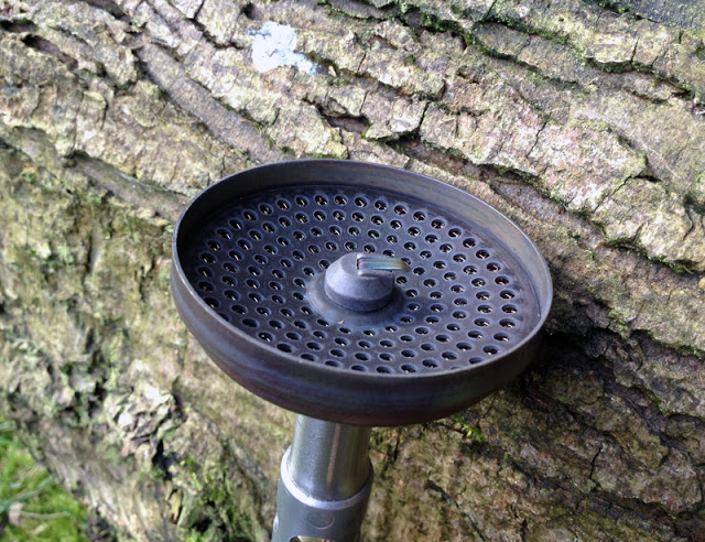

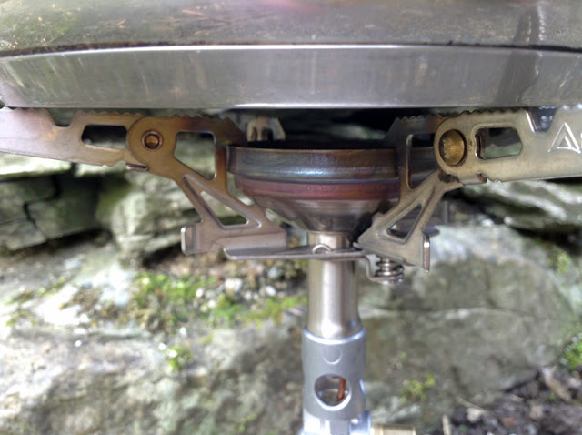

As the name suggests, the Wind Master is designed to work in the type of conditions preferred by sea farers rather than hill goers. The burner head is concave in shape and features a raised ring around its other edge. That combination helps shield the flame from the effects of wind but the pot supports play a part in this too and are set so the pot sits much lower and closer to the burner than is usual. There’s actually very little flame exposed to the wind, so it’s obviously less effected when things turn blustery. I usually always use a windshield of some description regardless of stove type but when time came to try the Wind Master, I didn’t. Conversely, I picked a day when gusts were hitting 40mph plus and I purposefully set the stove up out in the open with no natural windbreak.
Pot supports hold the pan very close to the burner which again aids performance when things get blowy.

The 4 arm pot support provides a nice wide base for just about any size of pan.
What about the other elements that made up my wish list then? At 85g it certainly isn’t the lightest gas stove available but that weight is comparable to others of a similar output and it’s a weight I’d certainly be prepared to carry. Weight is only part of the story though and pack-size is often equally just as important. Folded into it’s little bag, the SOTO measures approximately 90mm x 50mm so will fit inside a standard 450ml mug albeit with only a few mm to spare. Something I don’t ever recall seeing elsewhere are detachable pot support arms. The pot support on the Wind Master is separate from the stove and simply clips onto the burner. I think it certainly helps to make the stove more compact when packed but it also allows you to swap between a three and four armed support. The stove arrives with the larger four arm version which folds out to provide a very stable 140mm wide support; it’s more than enough for something like a 10″ frying pan and therefor allows what I’d call ‘proper cooking’. Many stoves that provide a wide support can sadly fail to accommodate  taller / narrower pots but in this case anything down to a very skinny 50mm diameter can sit safely on top. If you do want to use the three armed support then I’m afraid you’ll need to buy that separately, although, apart from a reduction in size, I’m not too sure I can see any great real world advantage in doing so but I’ve not tried one, so will reserve judgement.

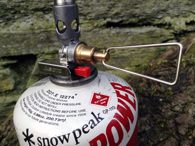

Aside from the piezo ignition – which I will say is nicely tucked out of the way to avoid damage, the Wind Master also has a ‘Micro Regulator’. I can’t tell you very much about it because it’s inside the stove but SOTO say that it helps to provide a much more consistent output in cold conditions. They go as far as to say that at -5c the Wind Master can be twice as fast as a stove without a regulator – it’s something which certainly adds to its bad weather credentials.
Mission control – ignition, regulator and the thing that turns it on and off.
