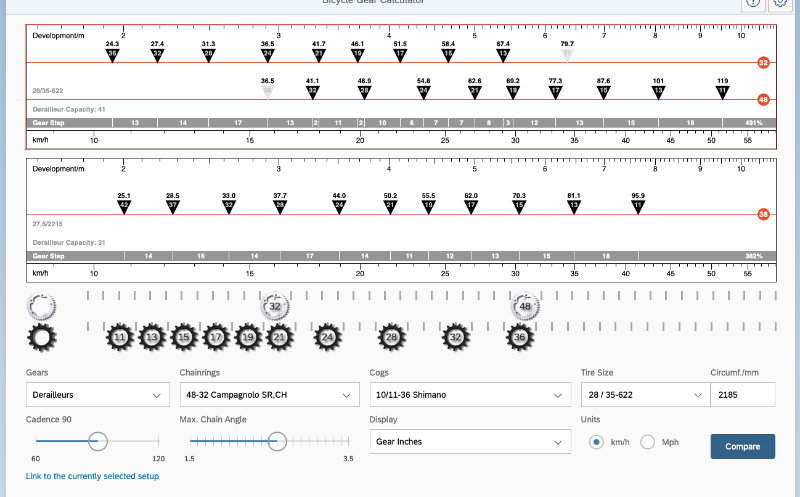

I know everyone loves Sheldon and rightly so, but I find this gear calculator easier to use than his as you can visually compare your current and alternatives.
This is my 2x10 'roadie gravel' setup compared to my 1x11 'gravelly gravel'.
