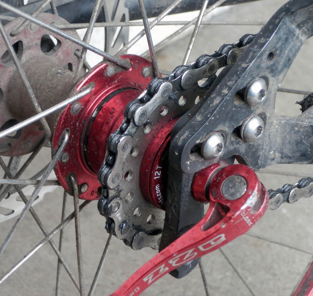

So I have been riding it now for a few weeks and I'm digging the single speed. I have ended up running 44/17. Here's a few pics. :)

I like the dropouts, they seem like a very good way of having a bike that can easily run ss or gears?

Ian wrote:Wheels look a bit small ;)
Don't help that it's a 29er fork! Some serious mud clearance now though. :wink:
Ben98 wrote:I like the dropouts, they seem like a very good way of having a bike that can easily run ss or gears?
It is exactly that Ben and now I can say it works very well for both.
The models previous to this one (it's a 2010) only used 2 bolts and a lot of people found problems with slippage. They eventually made a new replacement drop out that used the rack mount hole as a third bolt.
