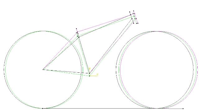

Sometimes I wonder if I go too far with these things... but you've gotta know the stats...right? :geek:
I've been looking into a new frame for a week or so (not long in the grand scheme I know) to keep built up as a singlespeed, and I guess you cant have too many bikes right?
Anyway, I'd convinced myself that some brands were out of the picture for me as I fall in between the sizes available. I always knew fit and ride was more complicated than just the seat tube size and the effective TT measurement. Such things as BB drop, fork offsets and the good old reach and stack figures.
Interestingly (to me), the below shows this.
Red: Kona Raijin 18" Frame
Blue: Salsa El Mariachi 19" Frame
Green: Salsa El Mariachi 17" Frame
Just thought I'd share...
(Yes, this is all after the fact as I tried one, and made my order based on feel)

Any chance you could do that again for the benefit of the colour blind amongst us?
Re: Frame Size comparisons...
just guess....
*The seat tube size is the biggest tell tale
Could you draw up a medium Charge Cooker onto that please? (bear in mind that the BB drop is much less than the bikes you've currently modelled). :D
ScotRoutes wrote:Could you draw up a medium Charge Cooker onto that please? (bear in mind that the BB drop is much less than the bikes you've currently modelled). :D
I can yeah. Would you want it compared to something or added to that?
Compared to that please. I'm on a Medium (17") El Mar and I'm looking at a Cooker - specifically for the higher BB. The Charge website reckons I need a Medium but an email from them reckons a Small. :roll:
its an odd shaped frame. comes up quite big.
Theres no reach and stack listed so I used the actual TT length and Effective to position the TT.
I'll take off the Kona.
Also, the salsa is based on the listed fork length, which is the one I think I'm going to use compared to what I have on the kona.
are you using a standard fork of some sort? Like a reba?
Here you go,
Cooker is based on a 100mm reba - Sagged 20mm which has an un-sagged axle to crown of 506 ish, the salsa is on a fork length from their site (483mm)
Hope it helps. Purple is the Cooker

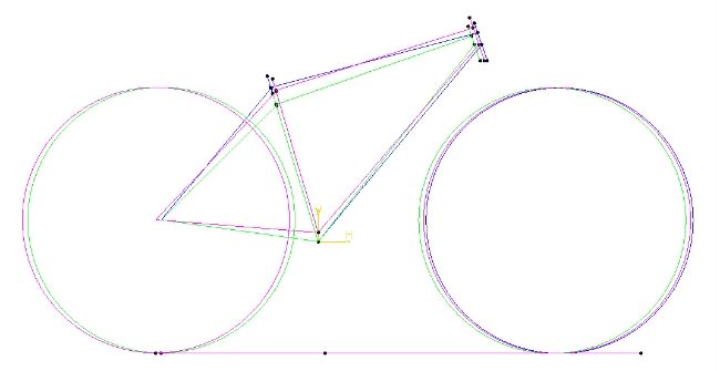

ok last one....(home time)
Green - Med El Mariachi
Purple - Med Cooker (with sagged Reba 100)
Black - Small Cooker (With Sagged Reba 100)
Just to remind, a sagged reba should sit very close to the same hight as the salsa fork.

FLV wrote:ok last one....(home time)
You're a star. FWIW, I'm running the El Mar with Rebas set at 100mm at the moment.
