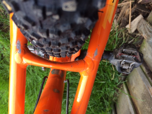

Al
Posts: 909
Re: Spearfish owners
Post by Al »
Room to spare!
