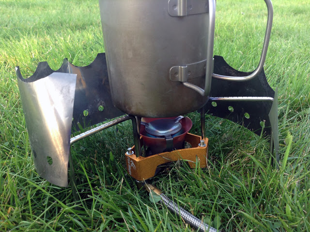

Not a catchy name is it? Although FMS-F5 doesn’t exactly roll off the tongue like warm velvet and probably brings to mind images of cold war jet fighters rather than idyllic camp spots, you shouldn’t let that put off. Name aside, the FMS-F5 is a very light and very compact liquid fuel (that’s petrol to you) stove that costs considerably less than most.
The supports will just about hold a 400ml mug if you’re careful. |

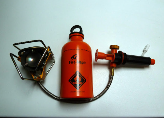

Stove, bottle, pump. The three elements of any petrol stove. |
Like most petrol stoves, the FMS-F5 consists of a burner unit, a pump and a fuel bottle. Fold out the three supports on the burner, screw the fuel bottle onto the pump and you’re good to go. The first job is the pressurise the fuel bottle with, you guessed it, the pump. Around 20 strokes should be sufficient to build up pressure if the bottle’s reasonably full but you might need a few more if the fuel level’s running low. There’s no pressure gauge or visual indicator but you’ll very quickly get a feel for it as the pump plunger become increasingly stiff as the pressure builds.

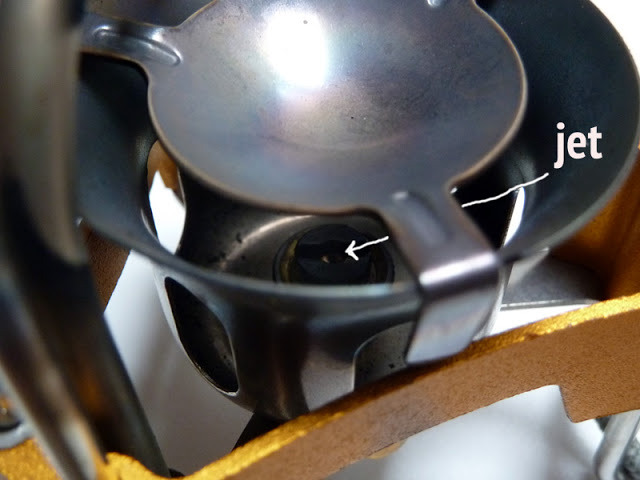

Your next job is to prime the stove by releasing a SMALL amount of fuel through the jet at the base of the burner. Slowly unscrew the valve on the pump until you see a SMALL amount of fuel coming through the jet, then close the valve. By SMALL, I mean a few ml, it won’t be any faster, quicker or better in any way if you put more fuel through. The stove doesn’t have any form of ignition so you’ll need a lighter or similar. The fuel may look hard to reach but remember, this is petrol, it’s not meths, put a flame or spark anywhere near it and I guarantee it will light instantly.
This is the priming / pre-hear stage burning the fuel you initially let out of the jet. |
The purpose of priming or pre-heating as we should perhaps think of it, is to heat the fuel pipe that runs across the top of the stove. If the pipe’s hot, the fuel will vaporise as it exists the jet. Pre-heating may take a minute or so but generally by the time the flame from the priming fuel has begun to fade, everything will usually be hot enough. Now, slowly open the valve on the pump again – I’ve found that a good couple of turns are required before much happens but go slowly rather than mad. As the fuel starts to flow you should see the flame in the burner increase in size. It might surge slightly at first but should settle down quite quickly. Something else I’ve found is that the stove is quite slow to react to any adjustments you make to the valve setting. It’s not really a problem, it’s just something to be aware of. In common with many petrol stoves, the FMS uses a ‘roarer’ jet system. Why ‘roarer’? Trust me, all will become apparent and you’ll be left in no doubt about whether it’s actually burning.
