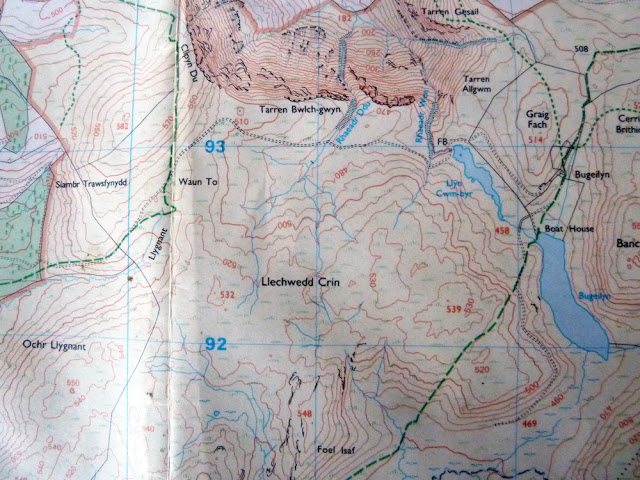

If you look at the section of 1:25k map above then you shouldn’t spot anything unusual.
Same map, different scale but there’s something missing. |
Now look at the same section of map but this time it’s a 1:50k version. Again, you probably won’t notice anything odd – same bridleways, hills, lakes and rivers.
Aha, the ‘Lost track of Bwlch-gwyn’. The source of the Nile was easier to find. |
Perhaps this highlighted version of the 1:25k will help? On the 1:50k the track from the east stops just about where I’ve put a box around the footbridge, yet there’s clearly a track marked here and a jolly nice track it is too. If you were trying to join east to west or vice versa relying purely on the information contained on the smaller scale map, you have but one option – Bugeilyn. If you recall what I said about bridleways in part one then you should remember that I mentioned how a RoW without black dashes beneath it may well not be a track at all … that is Bugeilyn, it’s boggy, it’s wet and it’s largely pathless. NOTE – although not shown, the track in question is actually permissive, so even the 1:25k won’t always get everything right.
