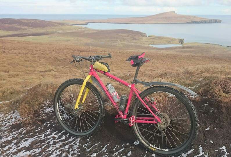

Mine's a 2014 charge cooker 3 xx with rigid forks and 2.4 tyres. Does me, though I do wonder about drop bars sometimes but the hassle doesn't seem worth it.

My rigid steel bike with 29x2.6 (mostly 2.4") is ssp and sees everyday use, get's 131 layers of dirt until it's cleaned. It should be that kind of bike for me.
