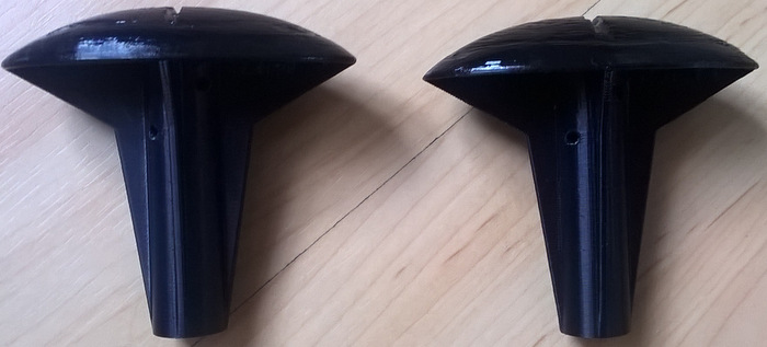

Not completely MYOG because I got it printed for me, but I needed a tent pole top piece for my cheapo Chinese tent and decided it would be a good excuse to learn a bit about 3d printing; here's Mk1 of what I ended up with ....
Imagemushroom2
Imagemushroom1
I wanted something to distribute the load of a tent pole across the tent material where there wasn't any reinforcement. OK I could of chopped up a tennis / pingpong ball, but I wanted something bespoke. Its designed to fit a 12mm pole (just about to order some shiny new pole-a-bear's from Stu), weighs 20g and 2 off cost me £11 to get printed.
ImageMush2
ImageMush1
If you're interested, here is a 3d.pdf https://drive.google.com/open?id=0B1glJ ... 2VpREw5TUk <open link in new tab, download and open in Adobe Acrobat> which is far easier to understand. I used https://www.freecadweb.org/ to generate the design and these guy's https://www.rennd.com/services/3d-printing/ to get it made (great service, will use them again)

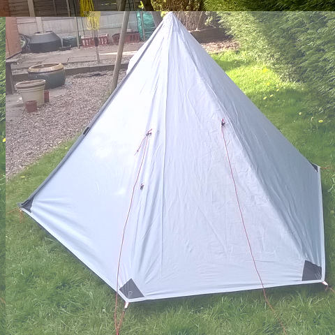

pryamid 1 cropped.jpg (53.33 KiB) Viewed 20534 times
Your design works a treat with the 3f tent , enables a taught pitch all around . Thanks for the share .

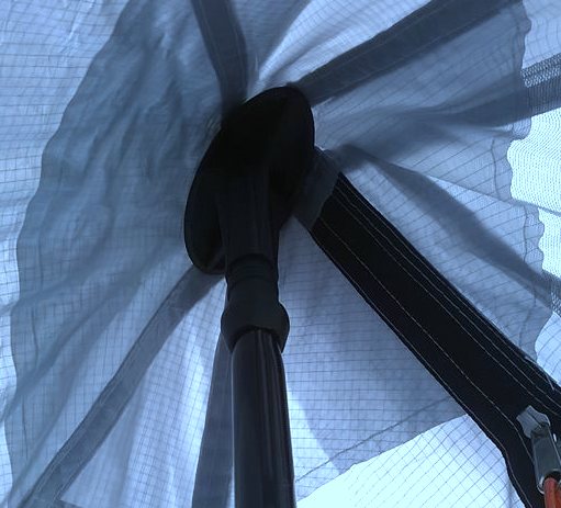

pyramid 3.jpg (99.14 KiB) Viewed 20534 times

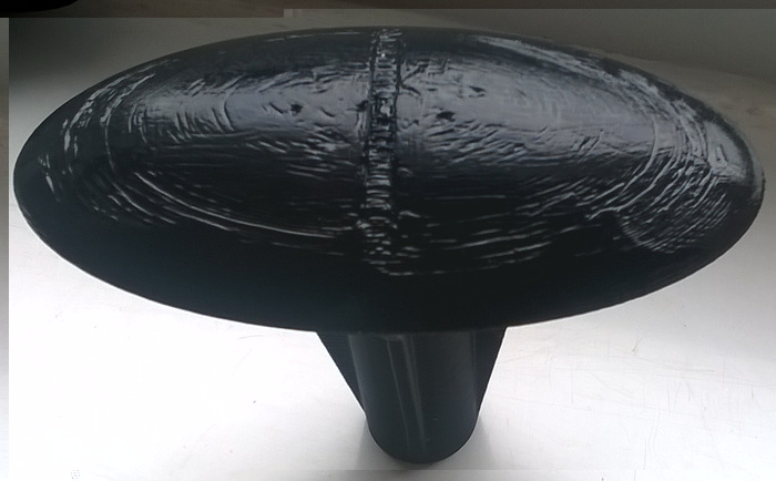

Rich kindly shared the shroom print file with me, I sent it to a friend who recently bought a 3D printer, last week I was presented with this…
One on the left is raw print, one on the right has been filled and lovingly painted.

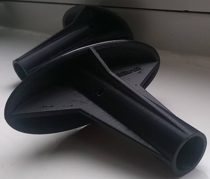

Rich3rd kindly sent me the files and now I have my 3d printer set up, I can confirm that this is excellent:
Printed upside down with some support material, so took a bit of light sanding to make it smooth.
If anyone is struggling for somewhere to get it printed, let me know, I'd be happy to print and post.
