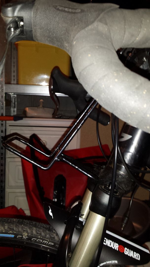

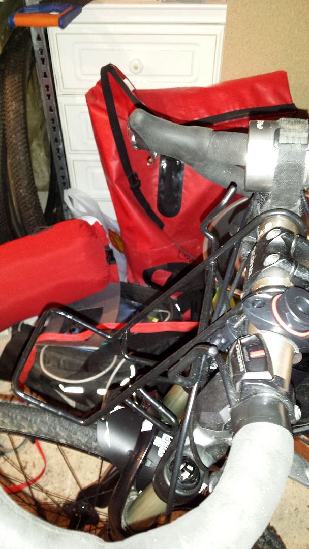

Not really MYOG since I didn't make it, it's a basket mount I bought from Evans for about £5.50
I had to open up the hooks to hang on the oversize bars nicely but that's it.
Used it on several multi day trips now and it's spot on. It's rock solid, easily clears the cables and dead easy to take on and off.
I did weigh it a few months back but can't remember the weight. It's not very heavy though.

Interesting. Is it just held on by gravity? Doesn't it rattle?

The lower stand off falls a fraction just below the fork crown. I've laced the webbing strap so as it is tightened it pulls the hanger towards the headstock and it all tensions up. Not sure I've explained that very well, ill try and take another picture.
Its absolutely rock solid.

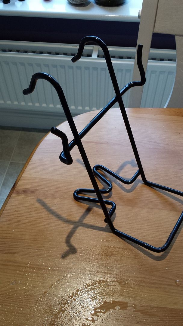

Just bought one, with a little shortening of the top hooks this will work a treat. Thanks for the top tip, have saved my money.

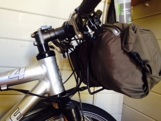

So here is mine, a bit of bending and hammering and it's all done for £5.39! It's rock solid and gives loads of cable clearance, I think it will work very well and better than my previous setup.

I've managed to get the lower stand to sit on the fork crown. Is that how you'very done yours or does it sit on the headstock? Can't quite tell from the photo.

It sits on the fork crown, tried it on the headset at first, but it wouldn't fix properly and was wobbly. Had to stretch it a little to make it fit, but once it was there it just locked tight using its' own tension between the bars and the fork crown, secured it with a piece of paracord and chord lock from an old bag for peace of mind, but I think it really doesn't need it.

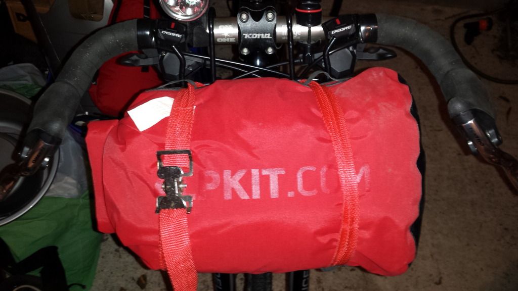

Hi Nathan,
Have never really thought of maximin or minimum weights. Try to keep the weight down as much as possible, always changing things around. On that trip I used a 13l Alpkit Dual Airlok. Inside was my sleeping bag, 3/4 sleep mat, sleeping bag liner, bivvy bag & down jacket. This weighed in at 2kg & was fine. My whole kit weighs about 6kg, plus water, continually trying to make it lighter. The more you carry the fitter you need to be, I always pack a few times before I set off, then when I return I remove what I didn't need for the next time. Hope this helps.
