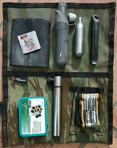

Posts: 4013
Re: Show me your tool kits!
Mack Workshop Saddle Wrap
Contents pretty self-explanatory!
Tooled Up!
Tooled Up!
