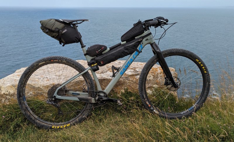

Watching with interest as I have the same frame (in XL and a better colour :wink: ) bought specifically to create a "UK gravel bike" ie rigid, Jones bars, 2.2 Ikons to cope with the majority of UK trails.
I tried it down some of the techy local stuff once and did not get far! It was not the tool for the job (or maybe I'm old and frightened nowadays), hence my interest as to whether a sus fork and dropper change it's character markedly.
It's comfortably under 10kg naked, although I will admit to breaking the yoke at the top of the seatpost recently so might have gone a little too light there.
SC Highball DorsetDivide23 small.jpg (198.1 KiB) Viewed 5783 times

Dyffers wrote: Thu Nov 02, 2023 12:46 pm Watching with interest as I have the same frame (in XL and a better colour :wink: ) bought specifically to create a "UK gravel bike" ie rigid, Jones bars, 2.2 Ikons to cope with the majority of UK trails.
Very very nice Dyffers. Agreed, you have the better colour scheme. Them Trav Prongs I had to go on, but ended up sold!!
