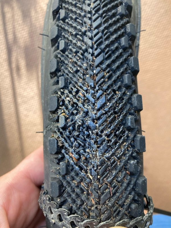

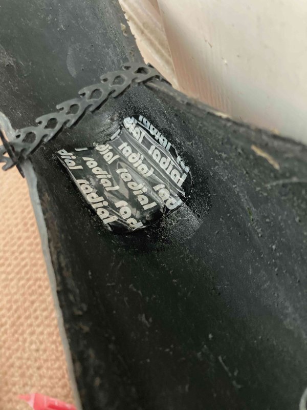

Well after some finger stabbing, I have managed to stitch the nice flap on my Venture closed. It must be a record for me, not even 450km on it and I ripped a bit hole in it. I've coated the inside and outside stitching in gue, left it to dry and now glues a car tyre patch on the inside. I manages to shape it so it follows the curve of the tyre and shouldn't effect it I hope. Just got to wait for the. glue to dry and hopefully tomorrow I can fit it an pressure test it to see if it has all worked. Fingers crossed!!

On the outside hopefully the stitching will be protected by the glue, any other suggestions of anything I can do to help it's longevity?

Perhaps don't use it as a front tyre..?
If the cut was long, keep an eye on it. If it doesn't bulge on the first bunch of hours riding, I'd probably relax and keep on using it as if nothing ever happened.
I strongly recommend using the horizontal mattress stitch :wink:

With glue and heavy duty patches, not mushrooms. It's Basically a c shaped flap, so I've had to stitch 3 sides closed. With the patch it just popped open and the patch started to come through. I don't think any other way would actually work as a permanent fix.

When I've had a large hole to repair I've always put a tube in and ridden it like that for a week after my repair. My logic is that the tube would pressurise the repair from the inside and force the patch onto the tyre. I've never had one fail after doing this. Just for info, I've also successfully used a Park self adhesive patch to repair a small hole on a tubeless tyre. I did it as a quick fix with the intention of gluing a normal patch on later but I never got round to it and the Park patch is still holding now (did the inner tube trick to smush it onto the tyre as normal). As others have said preparing the surface of the repair is the key I reckon, rough up the surface a bit and get it really clean using brake cleaner or isopropyl alcohol before trying to patch it.

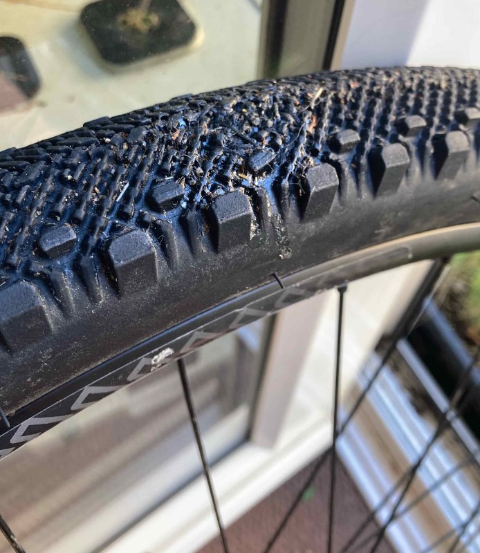

It did go down and there seemed to be some pin holes of air coming out round it, perhaps the glue didn't fill the thread holes?? Anyway I refitted it the correct direction and added some stan's race and it seems fine now, no loss of pressure, no bulge in the tread and no sign of sealant leaking through it. I'm taking it out for a spin on road today to fully check it's ok. Fingers crossed as I have my first Audax on Sunday.
40km of road and gravel and several days later, it's not lost any air or bulged in anyway so I am happy it's a permanent fix.

After another 300km's on it there is the sign of a bulge starting again. It seems fine to ride, I cannot feel it or hear it even on perfect tarmac and it isn't loosing any air. I was thinking about removing the patches from the inside, restitching the flap, stitching in a piece of slick tyre on the inside to give a larger area to spread the load over the damaged part. Then glue it all up again and cover with another patch on the inside. Not sure if this is overkill or I shouldn't worry about the bulge, or bite the bullet and just buy a new tyre, now I have had almost 900km out of it (450 pre flint strike, 450 post repair).
