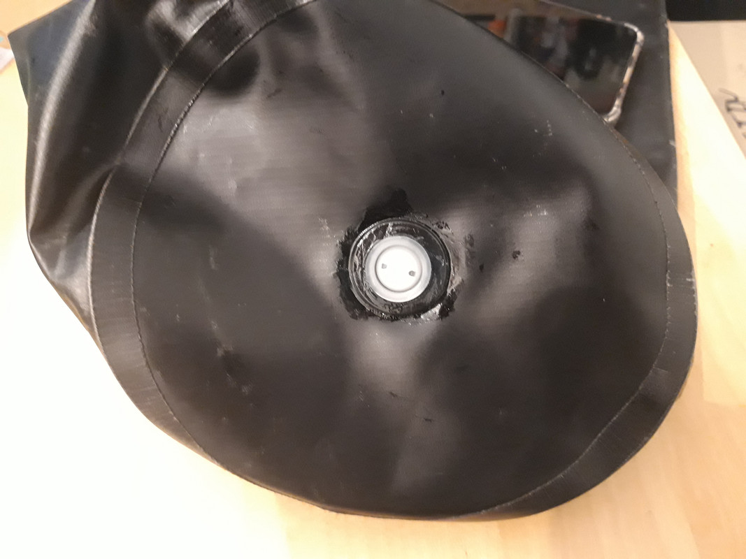

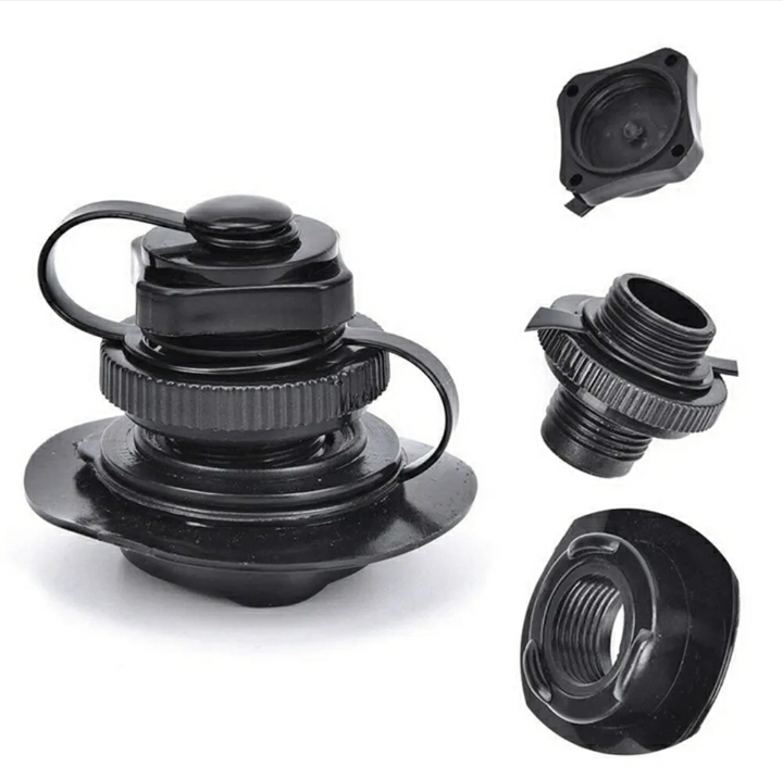

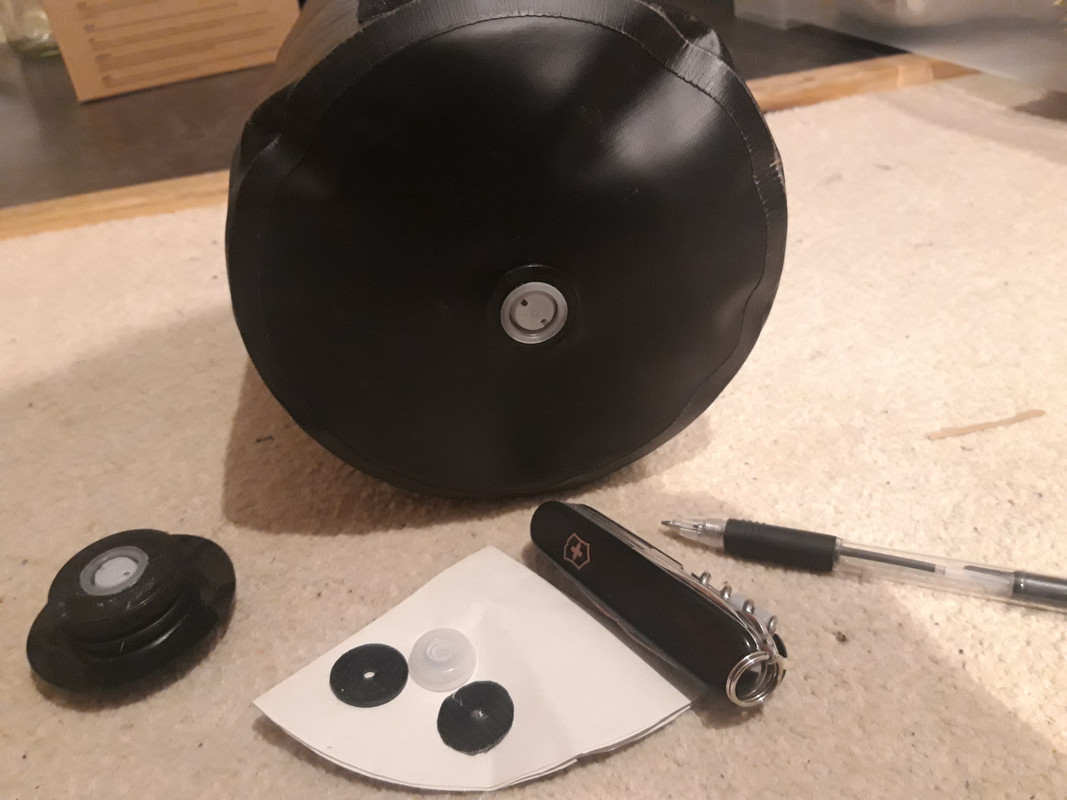

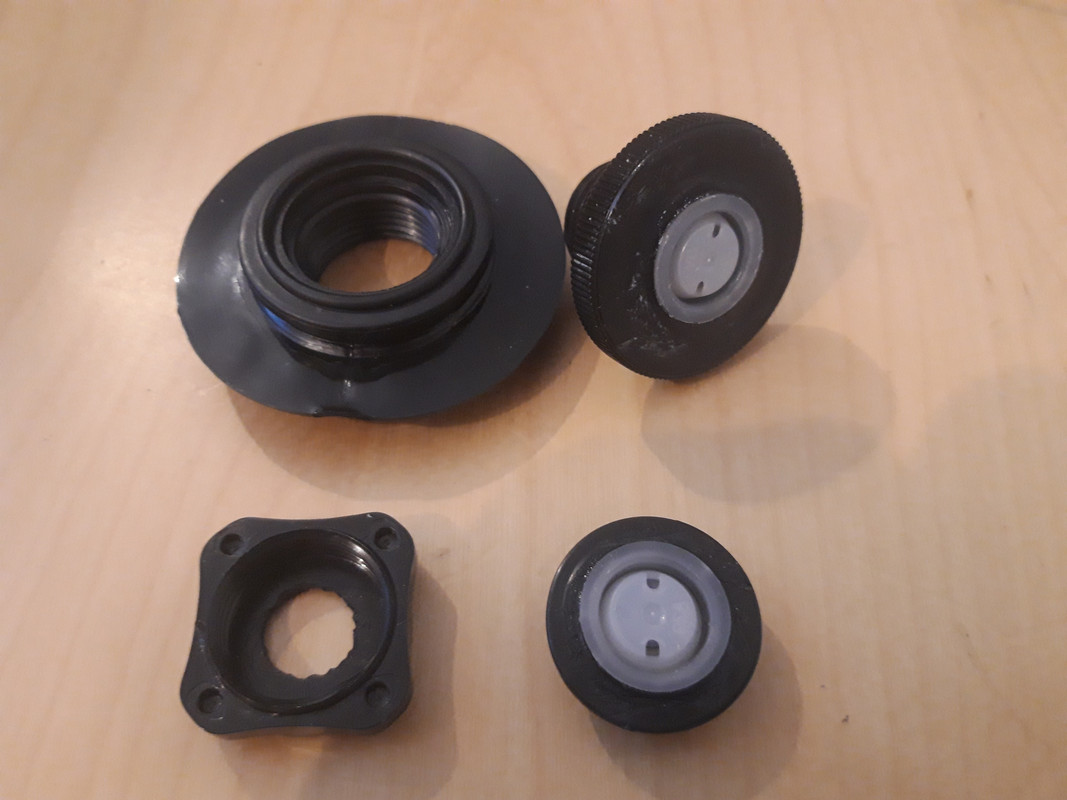

Success, after a fashion. Emailed adventureexpert.com and got a speedy reply from Kajo in Slovenia confirming no UK sales but suggesting Etsy (no joy) and ebay (neither), so decided to take a punt on one of these, which turned out to be massive
but after a bit of work with a Swiss army knife and the addition of a couple of those valves pointed out by dlovett
then a bit more cutting
and finally a bit of stormsure to make sure
it works quite nicely. You can hear the air being squeezed out of the bottom, but it should keep any water out. Overall pleased, though I'm still surprised those valves aren't more widely available. I think Silva use them on their bags.
