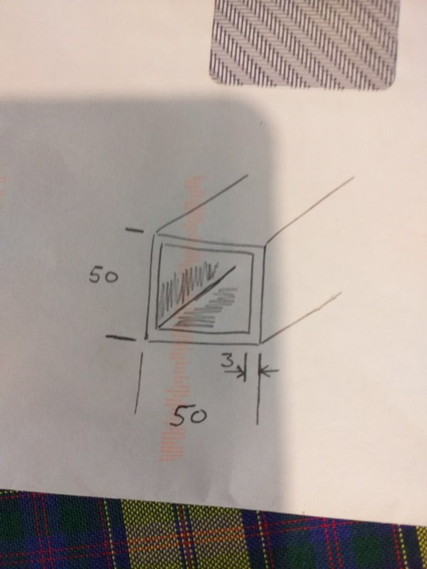

Shaf, I meant 50x50x3mm box section as photo. If it's awkward for you to find steel, I imagine wood would be ok. Probably best if it was pressure treated though as it's outside.
Disclaimer! I'm an electrician not a mechanical engineer. I don't know how heavy an awning is, or whether this is strong enough.

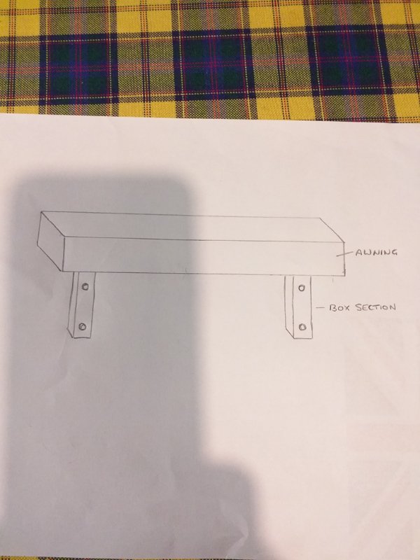

No idea if this would work or not. I'd probably drill through the wall and bolt through the box section with M10 studding then find a way of attaching the awning.
May be worth speaking to a builder first though.
