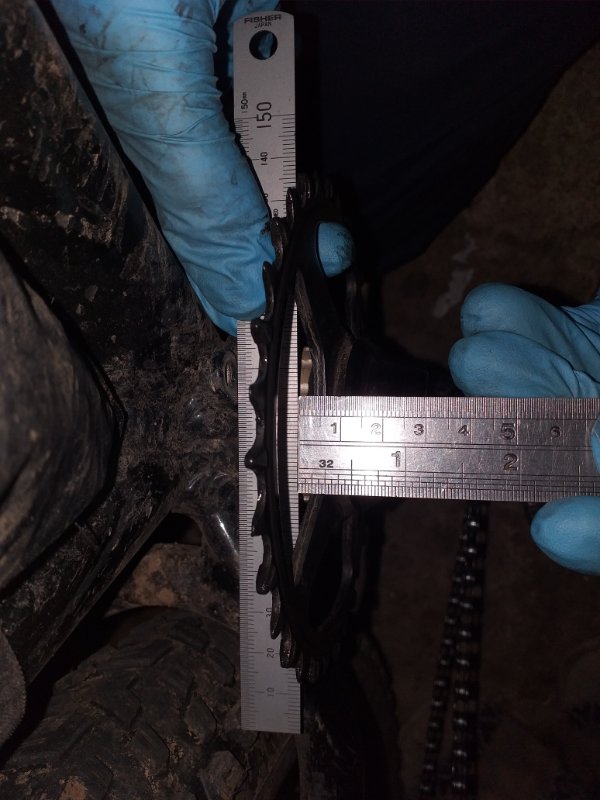

My crank is a Race Face Aeffect 32 tooth. Absolute black show two options here, a 6mm offset and a 3mm. Do they mean the offset created by the dish in the chainring?
I put a straight edge on the back face and measured to the mounting face, 3mm. So I need the 3mm version? Photo probably explains it better.

3mm is boost, 6mm is non boost. I use a boost ring on my hunt which isn't boost for the best chainline .

I can be a nerdy person, but I don't know a lot about bike standards so I've had to look into this.
So, boost relates to the wheel hub width, my rear hub is 148mm which makes it boost. Therefore I would need the chainring with the 3mm offset? If I'm wrong someone shout out please!

It's a bit of a minefield as there are a few variables but basically if your frame has boost spacing (yours does) you'll want a 3mm offset chainring, yes. Your current chainring seems to confirm this.
