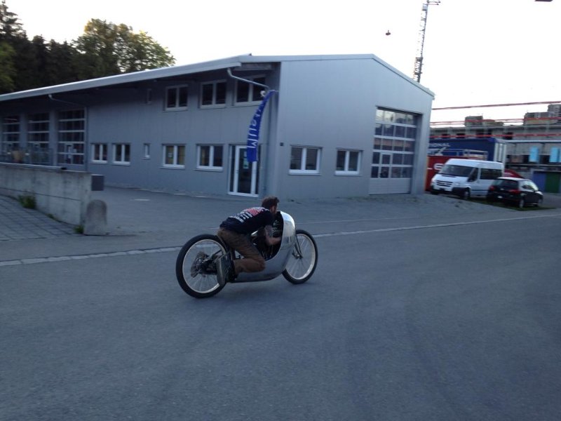

Posts: 2771
Re: Tyre speed ratings?
Mates fiddling about. Friend of a friend built his own based around a HD engine.
I asked about the tyres.
I guess it's just a narrow moto tyre.
Looks fun :-bd
Midnight break in to the velo drome, do some laps with such a beast sounds similar to riding a bike with mud tyres across a green.
Yeah... lots of fun
