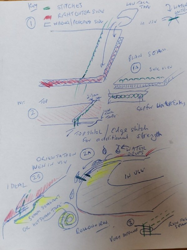

Re: Bivi bag seams
I made a bivvy bag (25 years) ago but it was a medium weight 1 ply goretex. Lighter than a NATO bag but too heavy compared to modern sacs.
I used run fell seams which where a night mare and seam taping wasn't available. I was breathable, weighed about 800g light for the time but bulky.
Now I'd just sew a plain seam, then follow it by top stitching on the upper edge, rain/water will flow over the seam. It generally not the stich holes water seaps in, but the gaps between where layers of fabric join. Top stitch also closed the join. Seam allowances are trimmed then iron on seal tape applied.
Tip# As you can't pin fabric, as you compromise the waterproofness. I use Prodec Low Tack Masking tape, to keep pieces in place.
This is better value & good enough Frogtape or Kleenedge are too expensive!https://www.toolstation.com/prodec-low- ... ape/p85936
(A few piece place where needed, like pins, rather than a long strip, easier to clean up)
Tape over the seam allowance it keeps fabric lines up. Or keeping a seam folded the right way for topstitching etc.
- ledburner
- Posts: 2040
Re: Bivi bag seams
Notes on seams attached diagrams.
