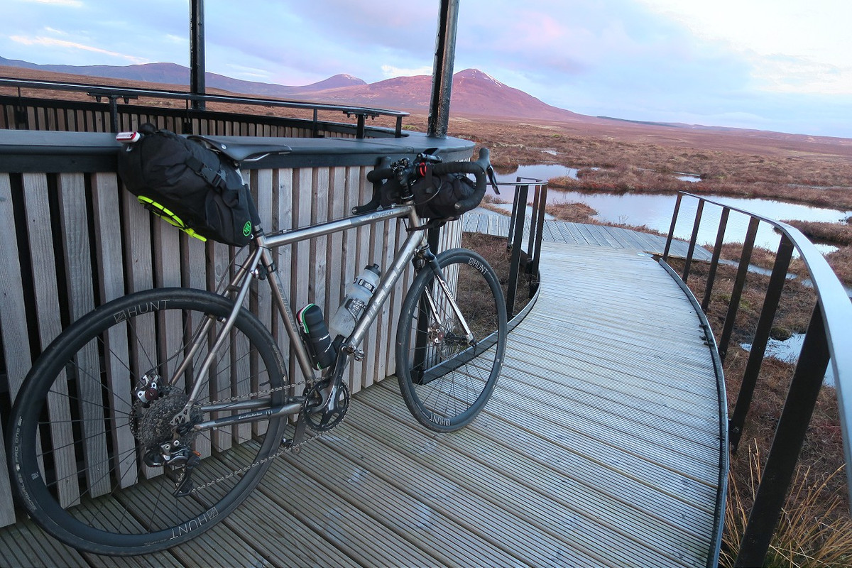

Re: Gravel bike gearing
Sram Force 1x with a 10-42 Cassette. Either 36 or 38 oval chainring, depending on the ride / load, wheels / tyres / etc.
That said, I would have considered e-tap 2x if it wasn't for the front derailleur / rear tyre interference problem.
Always focus on the lowest gear that I will need; I don't understand why people get worried about 'spinning out' on 1x, unless they are short course racing. The extra speed gained by pedalling above 30mph Vs the extra power required really isn't worth - drag curve physics!Landslide wrote:I'm riding the rougher end of the gravel spectrum, and I'm not bothered about going super fast on tarmac.
I reckon 40/11 top gear letsme pedal up to about 30mph (downhill, with a following wind); after that, I find I'm better off concentrating on my aero tuck.
