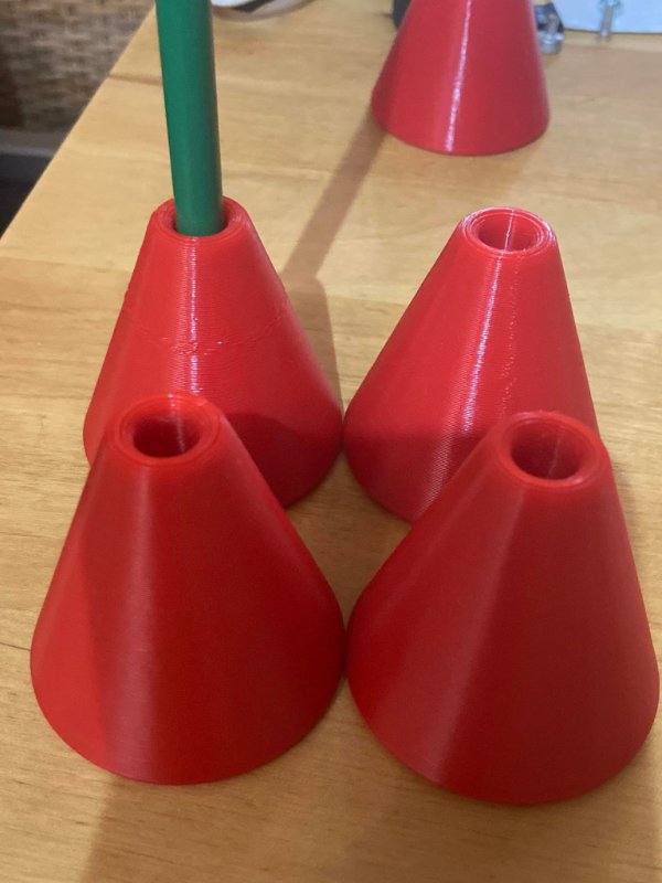

One of my friends asked me to help him out with a problem with his tent poles sinking into mud/sand when he camped. The brief was to make som feet that would not take up much space to pack and be very lightweight. After getting the pole measurements I designed and 3d printed him some pole feet in various styles. They are made from PLA which is an environmentally friendly biodegradable plastic made from corn starch among other things. I made several styles and these are the final ones which have now travelled to various camp sites and have been given rave reviews. The poles never sunk into sand or mud and he found them very easy to carry.
The first picture shows a pencil modelling instead of a pole, during the design phase.

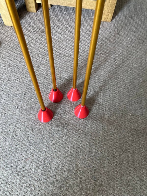

The final test fitting before they went off for use.
Re: Pole Feet
I'd consider making the base rounder Duncan. They'll obviously be very stable as are but should the tent decide to fall over, it''ll be more likely to bend / snap as you've set up a stress raiser. Ideally you want the pole to be able to fall over with the shelter rather than try and remain upright :wink:

Bearbonesnorm wrote: Sun Jan 22, 2023 5:51 pm I'd consider making the base rounder Duncan. They'll obviously be very stable as are but should the tent decide to fall over, it''ll be more likely to bend / snap as you've set up a stress raiser. Ideally you want the pole to be able to fall over with the shelter rather than try and remain upright :wink:
Do you mean more hemispherical?
Re: Pole Feet
Yes. Pretty much something without a flat base that'll fall over.
You can't really see from the picture but the base is rounded up to the sides rather than flat, but I will try even more weeble effect on the next batch to see how they stack up.

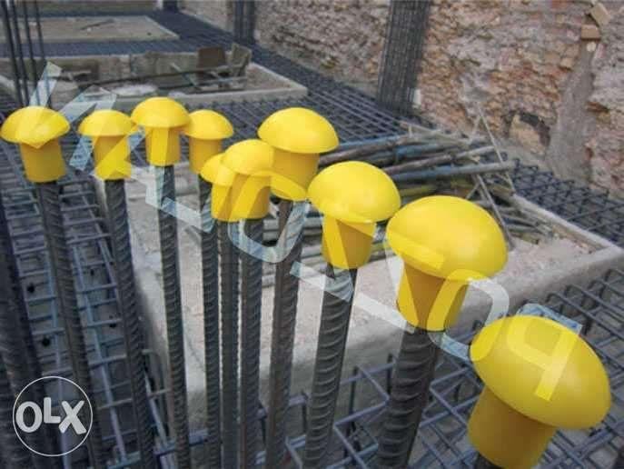

The safety caps they put on the end of the reinforcement bar on building sites is a good way of getting these cheap (FOC if you speak to a site chap them nicely - they buy them in the thousand and they're pennies).
