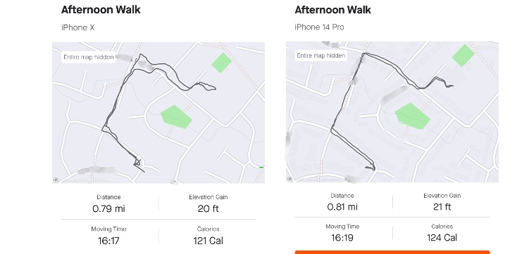

For full-day rides if I think I will need the screen on a lot I have a battery pack in a top tube bag plugged in to the phone on the handlebars. My old iPhone X would happily do a day of recording a route with the screen off, turning it on for occasional route checks, even with no additional battery. As the phone got older the battery life did drop off noticeably. I've recently replaced it with a 14 Pro and the battery life seems excellent. The GPS accuracy is also very good, which was the one real downside of the iPhone X (to the extent I used an external Garmin antenna).

I have been impressed by the GPS accuracy of the new iPhone. The X had terrible reception, much worse than my old iPhone 6 which sadly ended up on the sea bed, but the 14 seems extremely good.
See this brief walking test before I got rid of the old one. Both phones in my pocket while walking to the school. The X was all over the place at times, while the 14 even picked up which side of the road I was walking on.
