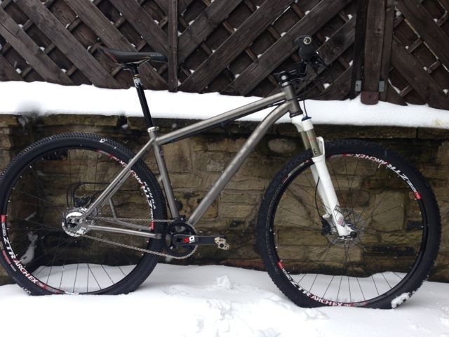

Re: Ultimate bike?
Ti. 44mm headtube. Sliders. 29er. Rohloff. Reba's 100mm.
I love it.
I've thought a lot about ti frames vs steel frames. What would I do if it snapped?
You could spend your time worrying over what ifs on any bike. From all the things I've seen break on bikes I think it's more likely to see a wheel disintegrate than a frame snap.
I was lucky enough to get the frame close to half price so for me, it was cheaper than steel.

Cracking looking bike that FLV, that's pretty much what I'm aiming for.
What frame is it (cant quite read it) and do you know what it weighs in total?

Re: Ultimate bike?
Cornish Neil wrote:Cracking looking bike that FLV, that's pretty much what I'm aiming for.
Its a Kona Raijin. Lynskey made frame.
http://www.konaworld.com/raijin.cfm
With the Reba RLT, Hope front wheel, Rohloff, Arch EX, 2.2 tyres, xtr chainset (not the xo pictured), XT brakes and nice finishing kit its slightly under 27lbs
I have some sids to go on it when I've mended them.
It has sliding dropouts but they're not lynskeys standard ones. I had a Rohloff specific slider made (modelled and had it cnc'd) but that wasnt the cheapest thing to do. neat though.
I know swapping to 1x10 xtr would be a fair bit lighter but I love the rohloff. My maintenance time on this bike has dropped to almost zero
