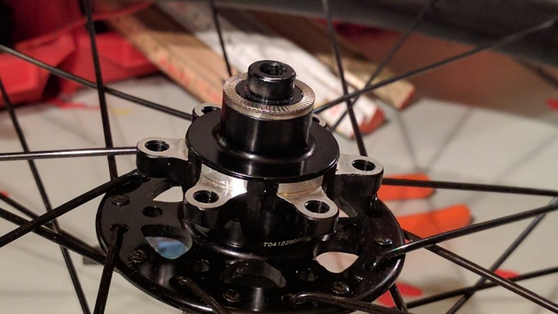

So wanted to inspect the rear hub to see if all was in good order. And came upon a new problem. Never seen this before. I simply can't figure out how to take it apart. On the freehub side, 17mm spanner fits. On disc side... No place to use the cone spanner and no lock nut, it's just round? . I'm sure there is a way, but have never seen this type before, any advice would be appreciated.
Edit : problem solved with 5mm allen key. :oops:

Post by mat_swan »
Allen key in the end of the axle?

Post by LSJ »
Yep. A 5 Allen holds counter. Thanks :-bd won't take it apart until tomorrow

Post by mat_swan »
Cracking. Be gentle with it, I've rounded one of those out before on a very similar looking hub. Still not sure how, those end caps are not normally that tight.

Post by firestarter »
Watch out for the washer in there mine was bone dry and folded in half it made an annoying hard to find squeak. A bit of grease sorted it out.

Post by restlessshawn »
Are they sealed bearing hubs on it?

restlessnative wrote:Are they sealed bearing hubs on it?
Yes, SB Novatecs. We have the axle conversion kits for 15mm F / 142x12 R as spares, the swappability between the Ramin and your other 29er was part of the spec decider there.
Ta, Thought they looked it in that pic, the evans site says "Hubs:Joytech, Aluminium loose ball" which confused me

Re: Pinnacle Ramin 3 plus - anyone got one?
Ahem. Confusion reigns here too : ) They're Joytech SB hubs on our spec list - Joytech and Novatech are 2 parts of the same company.

Post by LSJ »
When i took my rear axle apart. It was sealed yes. With NKG printed on them. Thought also it was loose balls, that is why the confusion on the taking apart thing earlier.
