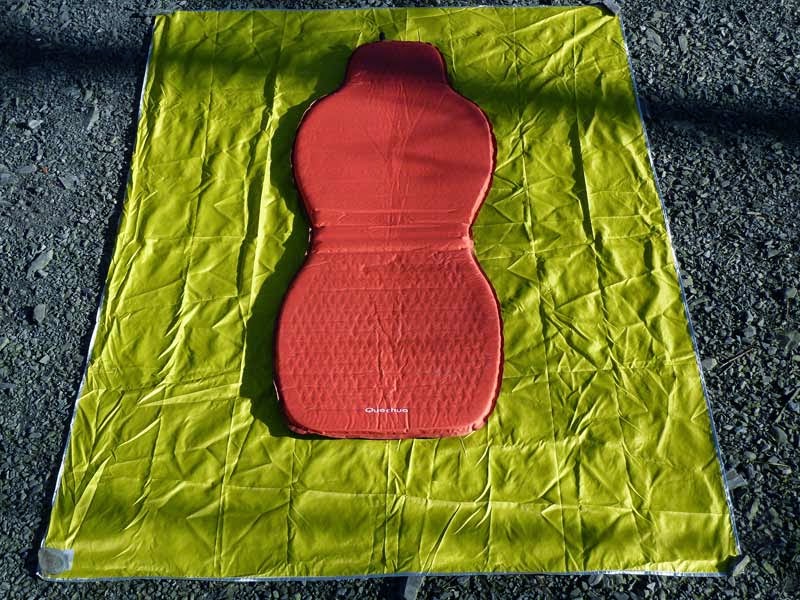

It’s quite a size when it’s laid out.

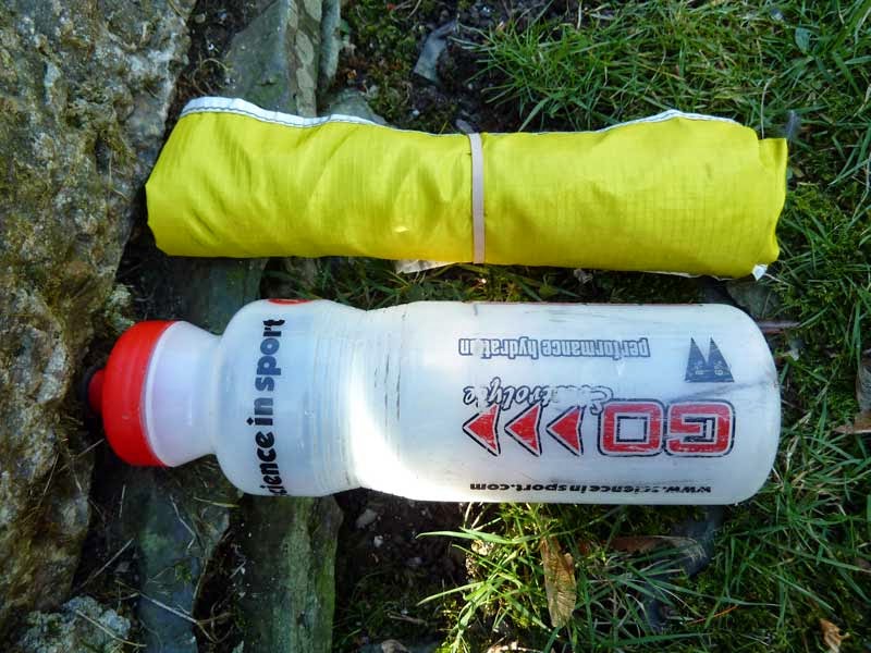

Although, not that big when it’s packed away.

The blanket weighs 125g* and can be folded, rolled or more likely, just stuffed somewhere you’ve a bit of a gap that needs filling. Once unfurled it’s actually quite a size, at a push you might actually cover two bodies with it. The first time I used it, I did wonder whether it would stay put throughout the night, I tend to move around quite a lot, so thought my continual turning-over might deposit it onto the ground at the side of me. I needn’t have worried, even if it does move a bit, it’s more than big enough** to keep you covered over, in all the times I’ve used it, I’ve yet to wake up without it in place … obviously if it’s windy, tuck it under yourself. However, of late I’ve been using the blanket inside my bivvy bag, not to prevent it moving or blowing away but to help minimise any condensation. Although breathable, the blanket probably isn’t as breathable (I’ve no figures for this) as the top of your bivvy bag and on occasion I have found more condensation at the foot of my bivvy than I would have expected given the conditions. Layering the blanket between sleeping and bivvy bag seems to address the issue as it leaves the top of the bivvy free to breath unhindered … it’s not a big deal, just something to be aware of. To make the task of getting into my sleeping bag / blanket / bivvy bag sandwich easier, I’ve attached a small piece of velcro to each corner … I stick the corners together and slide the resulting sleeve over my sleeping bag before popping it in the bivvy.
