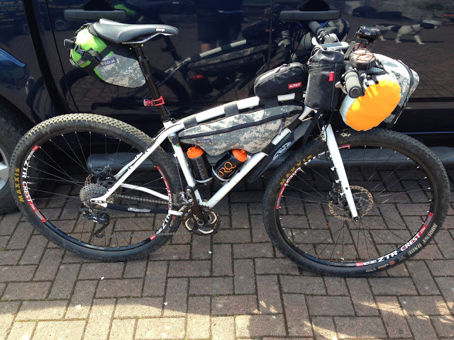

Hello again weight watchers – last time, I promised to return armed with a few real life kit lists and here they are. They’re taken from this years Welsh Ride Thing and give a fairly detailed view of what each rider was carrying … the weights stated at the side of the riders name are for EVERYTHING including bike and all water / food carried from the start.
I’m not going to conduct an autopsy on the lists, just read them and see how they’d compare to your own but it is obvious that taking more does result in a heavier bike. What’s also clear is that, weights of 40lb can be achieved without cutting corners or reducing levels of overnight comfort or safety … decent shelter, proper mat, a capable sleeping bag and warm clothing can all be packed and carried.
If you consider that over half the bikes at this years ‘weigh in’ tipped the scales at over 50lb and the heaviest was 80lb, you might start to wonder just what actually gets carried ;o)
Chew – Singular Swift 39.5lb
Front harness and 8L drybag:
Cumulus 250 quilt
Snozzle bag
Rab primaloft vest
Pound shop gloves
Bearbones bennie
Woolly socks
Merino top
Long johns
Pole-A-Bear alloy pole
Wingnut 2.5:
Exped synmat S
Bearpaw lair
Borah bivi
Marmot pillow
6 alpkit tent pegs
Multitool
Chain splitter + links
Lube
Tube
Toothbrush + paste
Sawer filter + bladder
Mug + stove + meths + lighter
2 pasta sachet ready meals
Cash
Taylor – DMO Element 29er 42lb
Frame bag:
Tools/spares/lube/tube/etc
Cook kit/fuel (400ml cup/BB 8g stove)
Lahoon
Small pack of bog roll and wipes
Tooth brush and paste
Head torch
Printed copy of route(6 pages of double sided A4)
Pole and Pegs
Spare batteries
Electrolyte drops
Sea 2 summit packable backpack for collecting food/sweets/alcohol on the way to camp
Buff
Money/keys
V.small first aid kit
Tick Twisters
Handlebar roll:
Enlightend Equipment 4deg quilt
Full length Neoair
Down T shirt
Smartwool boxers
Smartwool socks
Smartwool long sleeved top
Cheap Ronhill Trackster copies
Woolie hat
Handlebar bag:
Food (2 x porridge’s, 1 x mains. The rest was bought from shops/pubs/visitors centres).
iPhone with earphones
USB charger from dynamo hub for phone charging
SPOT tracker
Toptube pack:
Snacks
Seatpack:
Six moons Designs MK1 Lunar Solo
Alpkit feed bag:
Snacks
On bike
2 x 750ml bottles
42lb up and dressed
