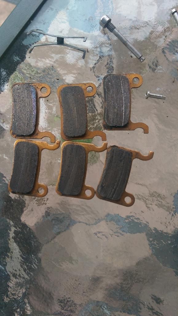

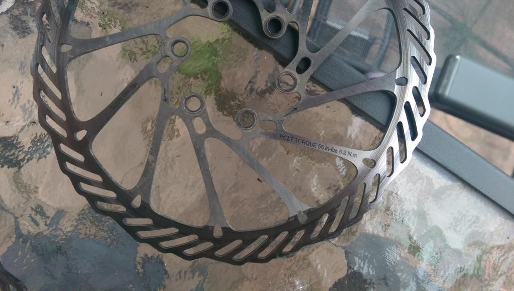

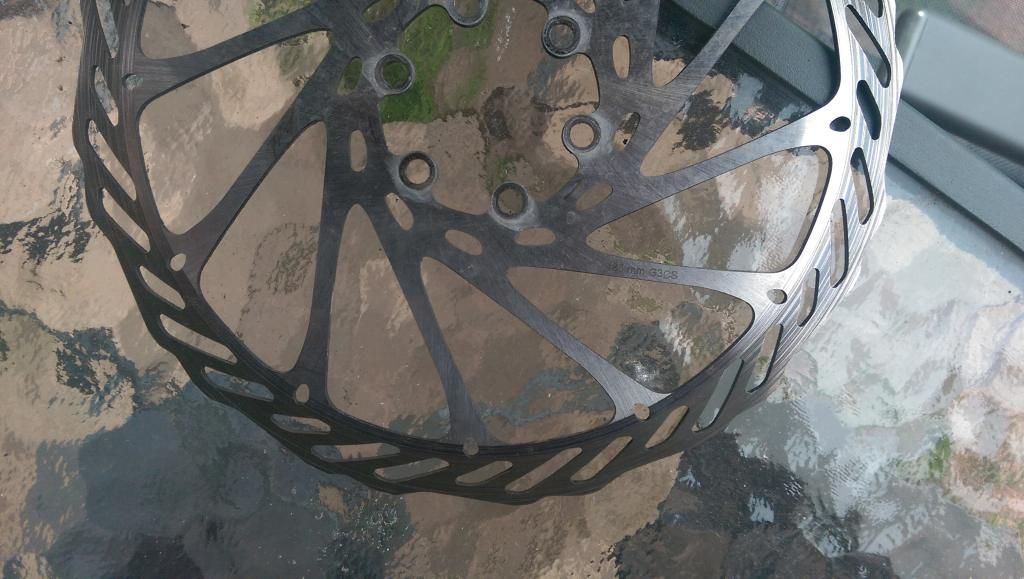

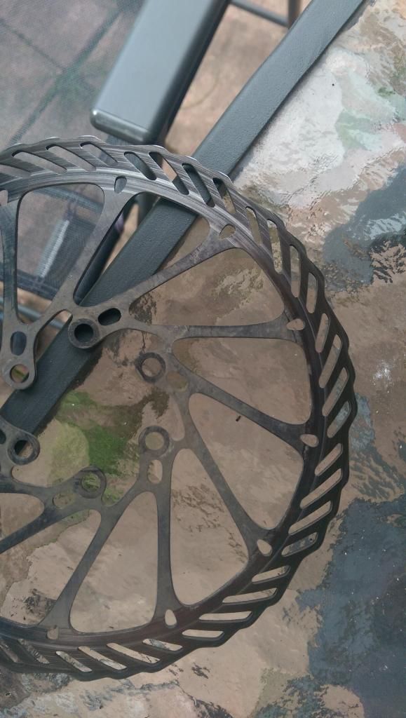

Started dismantling my brakes to have a closer look at them/clean them up, so i thought id post some pics. Discs look like they are ruined as they now seem heavily marked:-
Front Disc:
Rear Disc:
As with the discs, the pads also show signs of uneven wear, the first set its because i had things set up wrong, since then though I have had the calipers aligned correctly, or at least i think i have!
I guess ill try to clean these up and stick them back on for my commute and order some new discs/pads and see how things go from there!
Re: Squealing Front Brake
Those discs and pads (second set) actually look okay.
Zoglug
Posts: 302
Joined: Thu Apr 18, 2013 1:12 pm
Location: Manchester
Post by Zoglug »
s8tannorm wrote:Those discs and pads (second set) actually look okay.
Cheers stu, im going to clean them up this morning, see if i can use something on the pads incase they have become contaminated and see how i go with them! Ill leave off buying more for now! :-bd
