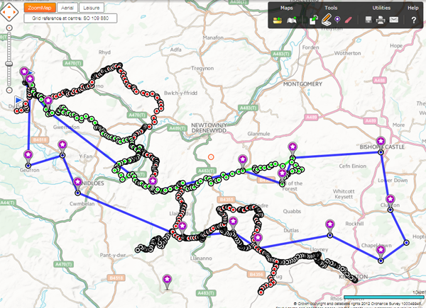

Here's a quick image of a similar method that Chew was talking about.
For this one I have used "OS Get a map" because its easy to enter a grid ref and then drop a marker. You can't do that on bikehike which is what I use when I plan a route without specific grid refs.
I have marked all the grid refs to start.
The blue line is a straight line between each to give me a visual reference of which direction I want I go when I'm zoomed in on the map.
The green, red, black lines are just bits of ideas and options. Eventually I would have enough options that a route will emerge from where the lines cross. :)
I also keep switching between the map view and the satellite view to make sure there is a track on the ground where there is one marked on the map.
If you think you need to use some country lane, then the lanes marked with the green dots are normally good ones to choose.
