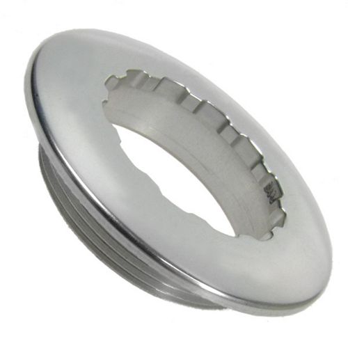

I have Shimano rotors, they're not held on with the Shimano lock rings. Beside, they said that it's an external spline lockring. For the avoidance of any more doubt:
External:
Internal:

Specific rotor type/make doesn't matter, just the lockring used. If external as below then yes, just a bb tool. Type of lockring is just down to axle/end clamp clearance right?
