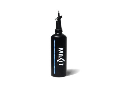

It's not a pump..but more like a large Co2 canister
The MILKIT TUBELESS BOTTLE is a pressure tank same size as a bike bottle
They claim it can re seat tyres on the go
I've not got one but have the valves which are real good

I've got a small Milkit bottle, I've managed to reset 42c tyres with it, but not necessarily at the first attempt.
