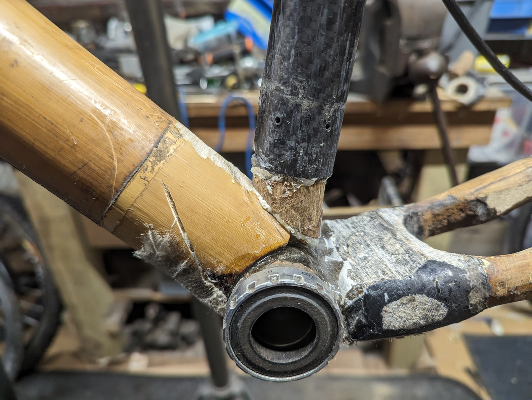

The bamboo bike is in bits, or more accurately something like the hundred thousand rivets flying in close formation that was the Avro Shackleton. Long story short, the bottom bracket junction has had to be completely stripped and while I'm reasonably confident I can build it up again in time for the Ride To The Sun at the end of June, there's a chance it might not make it.

Crude but effective, with luck. It was fine for ages, until the cf tube de-bonded from the bamboo socket that was the remains of the cracked down tube, resulting in flex while pedalling. I reckon it'll polish out with a combination of epoxy and fibrefix (now fiberweld).

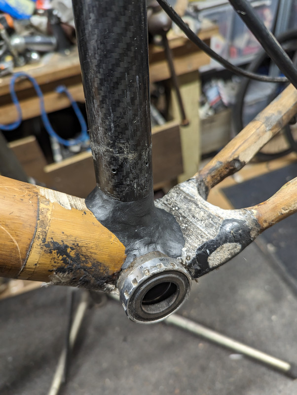

After stripping it all back, epoxy-ed in a section of broom handle to fill in the gap.
Added some epoxy filler to smooth the transitions.

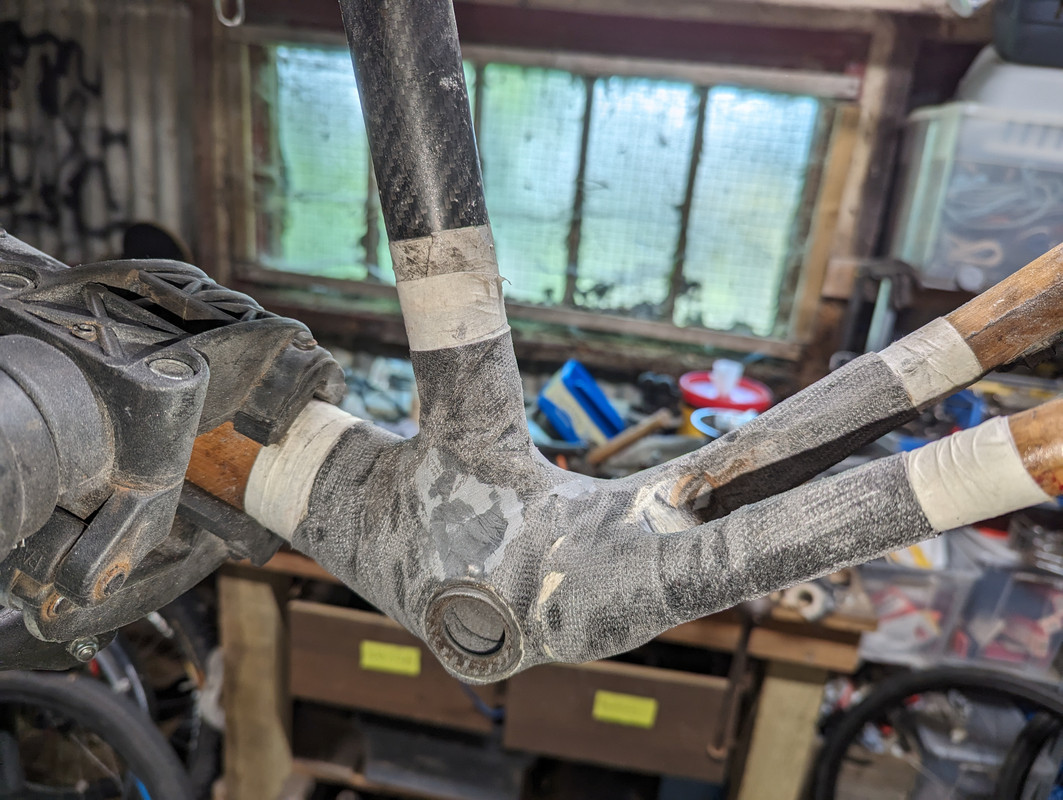

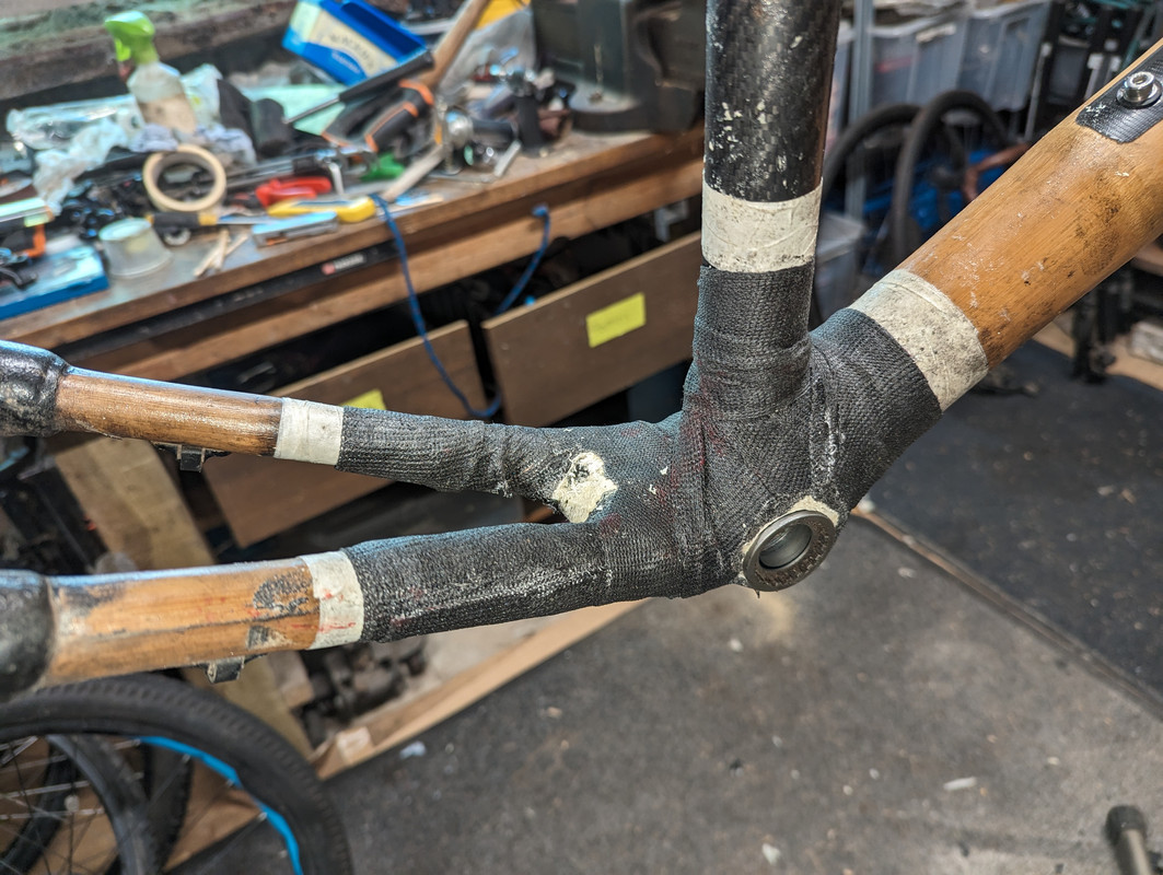

Wrapped with a couple of lengths of Fibreweld and some old Fibrefix.
Sanded it back.
...and took it for a ride.
The Fibreweld stuff is white and comes in a foil pouch covered in gunk, unlike the black Fibrefix. Both get dunked in water and then wrap quite easily. Bind them with bandage supplied or electrical tape for 5-7 minutes to compress. All good.
