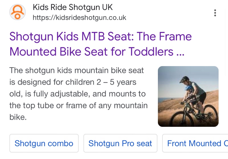

In my head, a manufacturer has designed that forked or spaced it to the forces required (here’s hoping) whilst a lot of manufacturers I’m guessing has not designed the rear stays for such use (and a lot now in design the rears to flex or to be more ‘compliance).jameso wrote: ↑Sat Apr 06, 2024 6:00 pmCarbon steerer tubes?voodoo_simon wrote: ↑Sat Apr 06, 2024 1:45 pm Its clearly.a bad idea to inflict clamping forces on a carbon tube
Don't get me wrong, the design does raise eyebrows.
It’s a bit like the kids shotgun carrier, they claim it can be fitted to any mountain (if I remember correctly) but I’m not sure the manufacturers would agree with this approach. Shudders to think what could go wrong
