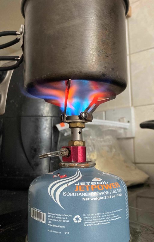

To answer my own question, now I'm happy I have plenty of gas, 300ml boiled in just under 2.5mins on about 3/4 power. Full power was far to much for my 650ml mug and flames were going round the side. Total used 4g of gas, so I should have about double the amount I'll need next weekend. Might have to open a pop up noodle bar enroute!!

Duncan, if you have a look on YouTube for a channel named "Gear Skeptic" he did a couple of videos on stove efficiency rather than outright speed. Actually I'm sure I've posted recently about them, he's really geeky
. Basically having the stove set low enough that the flames aren't lapping up the side of the container is most efficient. Apparently having a lid makes little to no difference, talking tenths of a gramme here at most.

Yep I did turn it down a bit after the photo. Forgotten how fast and powerful the little bugger is.

It is easy - Put your hand a couple of inches above the pot when it is being heated. If you feel heat (not just warmth) coming up the sides, then that is heat wasted. Just heating air. Admittedly also a bit of the sides, but mostly wasted.
Turn the gas down until that heat up the sides is minimal. Takes longer to boil but uses less gas.
