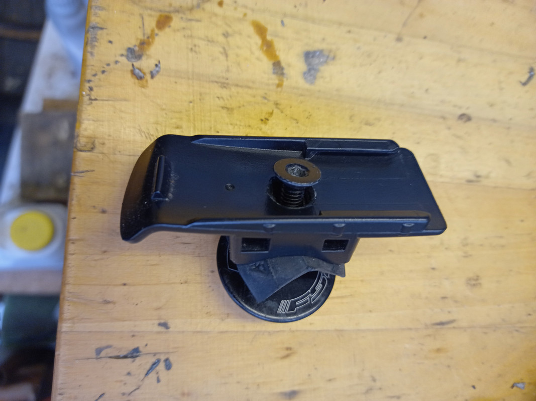

Been following this as I don't have much space on my bars
I seem to have found a simple, free solution, so far good for a few hundred off road miles
I used a countersink drill bit on the square hole that would retain the rubber seat, so that the star fangled screw sits down nice and flush.
Dispensed with the rubber seat but added a rubber "washer" cut from an old inner tube prevents rotation and perhaps the slight up curve of the mount holds the Garmin tighter than before but always use a lanyard anyway.
Will add a photo later

Interested in that Amazon kit. My DIY effort, (v similar to Javatime’s) has worked well but now, after a good few hundred bumpy miles, the female stem-top bracket has failed. It may be down to a poor quality bracket but I’ve always thought the extra height of my DIY gizmo was likely to increase leverage.
