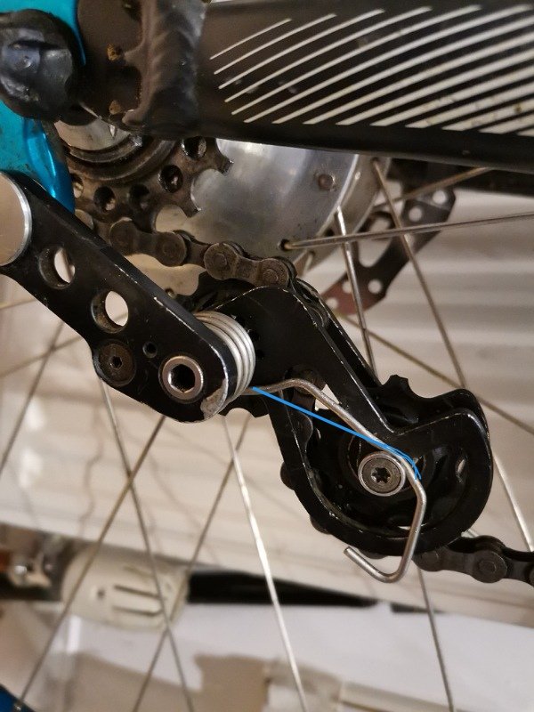

I,ve 'modded' spring on the rohloff chain tensioner, by extending the spring tail. The only way I Could do this was by unwounding it a, full turn. . I don't think it has affected the chain tension but I now have something grab on to it when releasing the spring or putting it back. Before that it was, a 'gefingersnappen' owner beware poor design. The sprung wire hooks over a post with a locating groove. It seem easier to fit or release. I will find out it this successful on the rough.
The line in blue was the original shape
- Rohloff tensioner spring mod
- IMG_20210215_223956.jpg (92.56 KiB) Viewed 3137 times

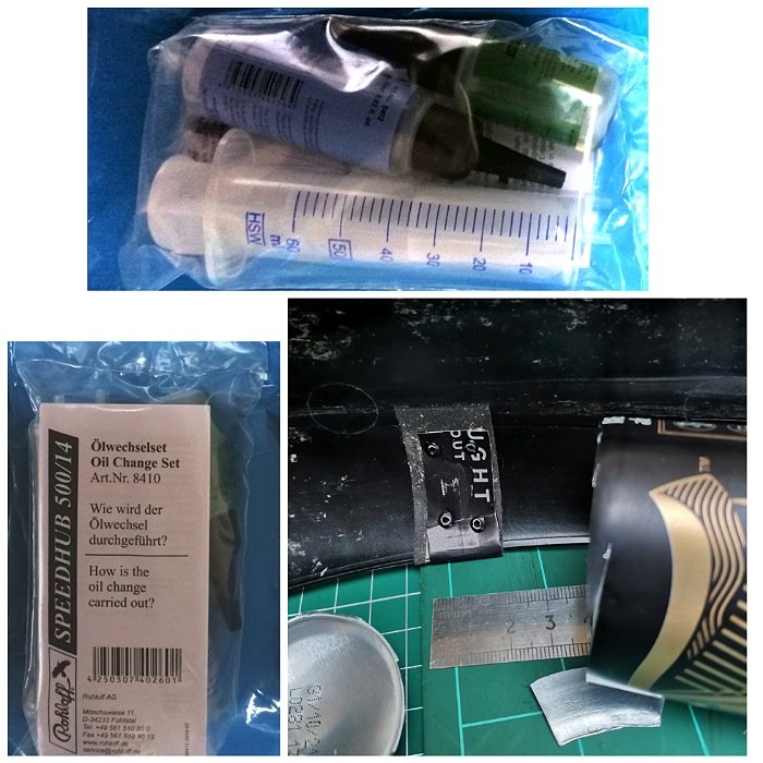

Repaired a crack in a front mudguard. I used, tiny 1 mm drill to stress relieve the crack. The double sided tape, a beer can & tiny 2mm pop rivets to fix it together.
Also , as noted in postman been the ad. Also done a rohloff oil change.
Also considered a pedal swap fatties to Time Atacs platforms...
- What I've been up too montage..
- IMG_21022021_050548_(700_x_700_pixel).jpg (98.83 KiB) Viewed 3055 times

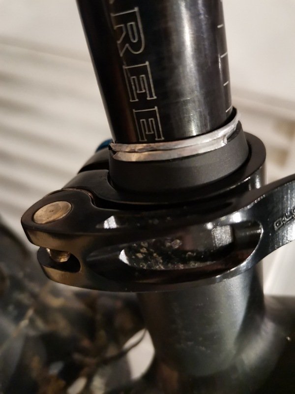

Yesterday I put heat shrink a rounf some copy nokon cable outer, so the would chip of make a racket tining against the frame.
**warning Wallace & Grommet tech. solution **
Today I modified pop can for a home made seatpost shim in two. Rub the paint coating off it hopefully it will work.
Background:
It was, To make up for a slightly under size ThudBuster ST seat post (off fleabay) . It going relativitely cheap. I stated it was 27.2 and I had a USE shim for 30.9 - 27.2 - perfect. A few weeks later I discovered the seatpost was really 26.8. So. 0.2mm under DIa. or 0.4mm to make up. I think the seller made, a genuine mistake.
So the shim was 2 wraps from the ally can. (0.1mm walls) made up the gap. Unfortuately
Every bump made it slip A teeny tiny bit, so every so often. I noticed the difference whilst climbing , as my legs faded when the post had slipped down more than 25mm. It required frequent adjustment
. I deducted the print & plastic lining were making the post slip, as was the double wrapped shim.
today I tried a different tack.
I) rub off the paint on outside and plastic coated inner. So it wasn't slick.
ii) cut the shim in to 2 pieces, align the gap on shims with notch in seat post, so it all nips up when seatpost is tightened.
This seems to have solved it. Time will tell, sovfor a test tomorrow...
Thin shims x2( silver) , USE thermo plastic, conical top (black,)
Background:
- Temporary seatpost shims, Pilsner can

Yes... good point Paul. It has the 5 year warranty (and their strongest frame as per emails when I bought it) so will most likely get it sorted that route. If they say no then it'll just get smashed for market research purposes...
The crack is between the seat and chainstays (a funny bridge) and knowing that most reputable repair places dont repair stays (too much risk), I'm gonna confidently say they'll most certainly say this is a 'lost cause'. Lesson learnt (for thinking a 1200g carbon frame could be tought enough for mtb-ing)...
