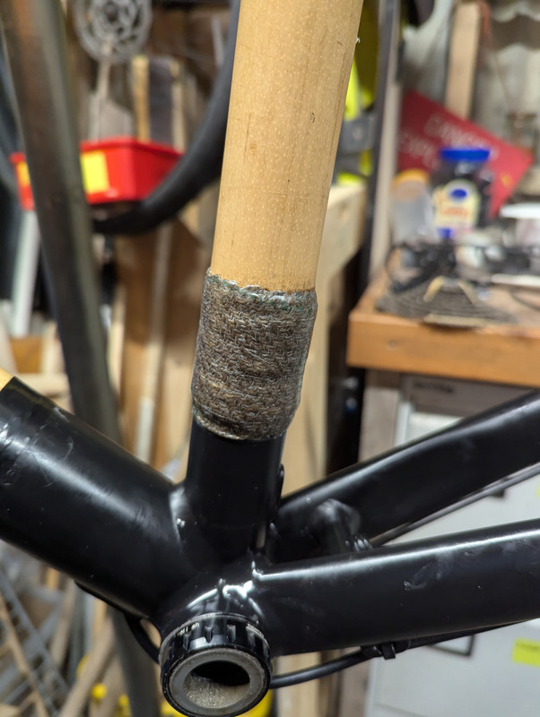

Was. Taking it for a ride there was an unmistakable knocking/grinding which I was hoping might just be the seat post slipping so added some carbon paste and took it out again and this time the problem was clear.
Yep, that's the bamboo having sheared completely where it's bonded into the top of the bottom bracket junction. Reckon it happened going over a speed bump two weeks ago on its first time out. Glad to have it happen now rather than later but now what to do?
1. Contact the company and ask for advice.
2. Wrap it in carbon fibre tow and epoxy and hope for the best.
3. Remove that section of bamboo completely and bond in a length of 31.8mm diameter carbon fibre tube (ideally with enough space internally to fit a 27.2mm dropper).
4. Other (answers below).

Annoying and your thread has somewhat dampened my enthusiasm for building
1 then 3 followed by 2. *
* possibly use a steel sheath but it will look poor and add weight
Like this but not alluminium
https://www.ebay.co.uk/itm/171269222696 ... d_source=1

That's not a bad shout. Clearly the bottom bracket area is where most stress is applied, so in a way it's not surprising that it failed there (I was expecting the seat stays might be a problem, which they still might be).
I'm not averse to adding weight for guaranteed strength. Being philosophical it's just another stage to the build, which continues to be an enjoyable process. It's not been quite as simple as expected, but if what I end up with is a hybrid of the two approaches so be it.
In that frame of mind, I'm tempted to liberally wrap it in duct tape temporarily and take it out tonight for BaM. That'd be silly though, right?

I was about to say 'looking good, gecko' until I saw the sheared tube....
Seems a classic stress raiser induced fracture but I'd have thought that the bamboo would deal with that fine.
Be interested to see what BBC say, it would be a bit of a shame to have to use the dreaded carbon. Maybe grind away more of the alloy lug so no sharp edge where the tube goes in?
Keep at it! :grin:

Cheers Phil. Advice from the supplier is to either add a layer of flax or carbon around the break to reinforce it, or do a rebuild on the front triangle. They’ve not seen this happen before incidentally, and it’s entirely possible I was insufficiently careful with my cutting/shaving of the bamboo and introduced stress risers by cutting too deeply.
At any rate I’m inclined to wrap every joint, for peace of mind’s sake, and hopefully that way it’ll last ten years.
(The advice on the jig was to use sandpaper by the way, which seems obvious now, and they offered to send a replacement.)

The epoxy was still tacky yesterday (cold shed) but it's hardened nicely now. Think I'll leave it like this.
Tempted to do the seatstays too, to be on the safe side, but might use cf weave for that.

The weave was left over from bamboobike1. Hoping it's done the trick.

Don't know why I always feel the need to rush with epoxy but I do, and the result this time was a bit messier than hoped for, but it'll hopefully add some protection in the event of a crash or whatever.
This batch (on the left) was still a bit soft after 48 hours but after another day it had hardened properly, enough to risk building her up and taking her out (yes, 'her'. I live with five sisters and know whereof I speak). Nervous though, a bit like after a broken leg or bout of depression when you don't want to risk a regression but wih no creaking or cracking I think we're finally good.
