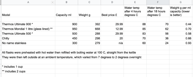

I did some home science with the kids, to assess the performance of our various insulated flasks.
Thermos Ultimate comes out on top. As expected, the 900ml one performed better than the 500ml one.
Surprise finding was the good performance by the old school glass-lined Thermos Mondial model, which is much cheaper, though also heavier and much more breakable. But I have found that glass bottles are bit more resistant to the accumulation of a gamey, thermos funk that is a hazard if you regularly fill your flask with pre made coffee and tea. I tend to use my metal lined ones for hot water, and brew on the road. Also interesting was just how badly the no-name stainless flask performed.
Hope this helps!

Good work Jack :-bd

In the interests of completeness I'd like to put the Thermos Ultimate head-to-head with one of the Zojirushi models, which are the only other flask/insulated mugs seem as highly rated. But I don't have one. But I don't really see that there's any real world need for better performance than the Thermos Ultimate.

That chilly one is shocking
