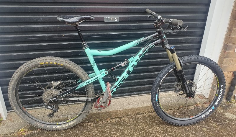

Picked up a free frame from Facebook last week 😃
On-one codeine 27.5 without a shock. The spare shock I had in the garage was the right fittings, but significantly shorter. Thought I'd give it a go anyway, so built the bike up with stuff from the garage/my snapped Jamis.
Ended up very happy with the final version - pretty much the opposite of a "bikepacking bike" but very lovely. Original design was 150mm travel rear, 160mm front, and a 66 degree ish head angle. Ended up at about 120mm rear, 130 or 140 front (can't remember what the old forks are set at) and a 63° head angle. BB is pretty low, but I'm only running a 30t chainring and will make a nice bashguard for the ISCG mounts one lunchtime.
Rides really nicely - a few pedal strikes more than usual, and the "small" wheels feel a bit odd after the 29*3 on my usual stooge but it's a great little mini-dh bike which climbs pretty well too! Total expenditure so far is £25 for a front tyre and £2 for a cable, so I'm very much impressed!
