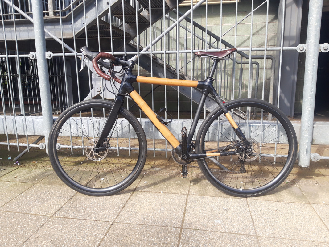

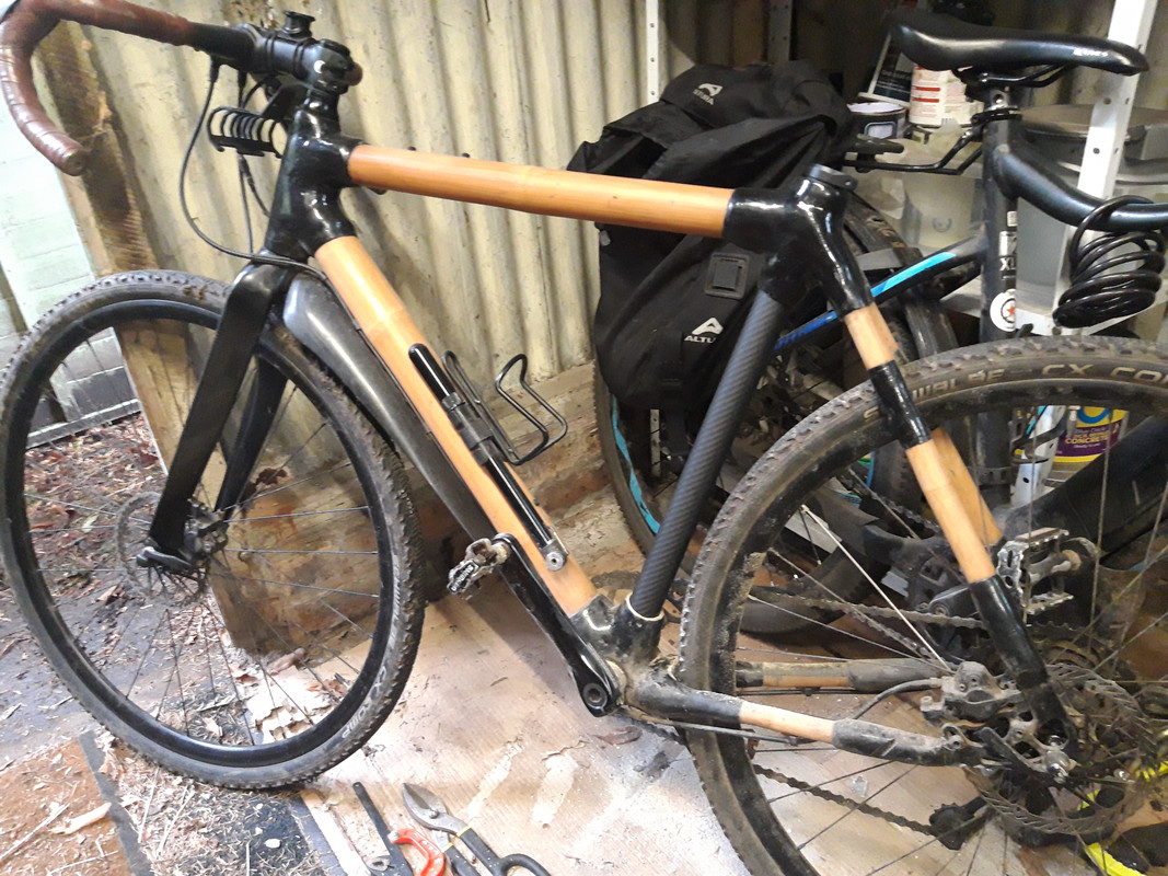

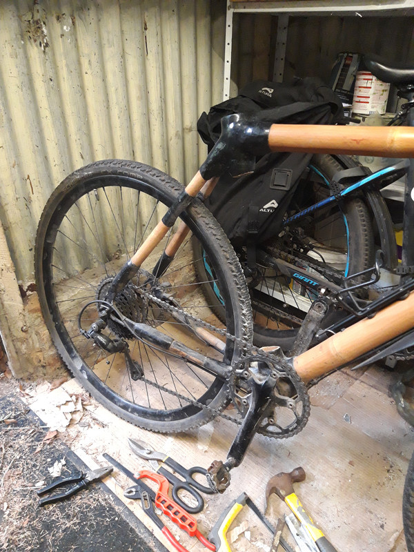

by gecko76
Added lightness
And then took some of it away again
Tools used: all of them.
Needs glued and sealed, then just waiting on a seatpost shim. Pondering adding bottle mounts.

gecko76 wrote: Sun May 07, 2023 1:04 pm Added lightness
This looks interesting! Any more pictures?
Quite amazing you can take out parts of the frame and just replace it, never thought of that!

by gecko76
Fitted and glued, and no ominous creaks or cracks.
Bottle mounts can wait for another day.

by gecko76
It wasn't the seatpost. In fact a hard twist of the saddle moved the entire seat tube a couple of mm, so clearly the araldite hadn't done the trick. Further brute force proved it.
Never mind, got the whole thing out (being glad I'd gone for the thicker carbon fibre, and not installed bottle mounts yet), cleaned it up with sandpaper and IPA and tried again.
I did think about using Gorilla glue before but I didn't have any plus I've never used it before. Funny stuff.
Let it cure for a couple of hours then cleaned up the excess and left it overnight. All good but still a creaking sound this morning so I tightened the headset and that's fixed it. :grin:
