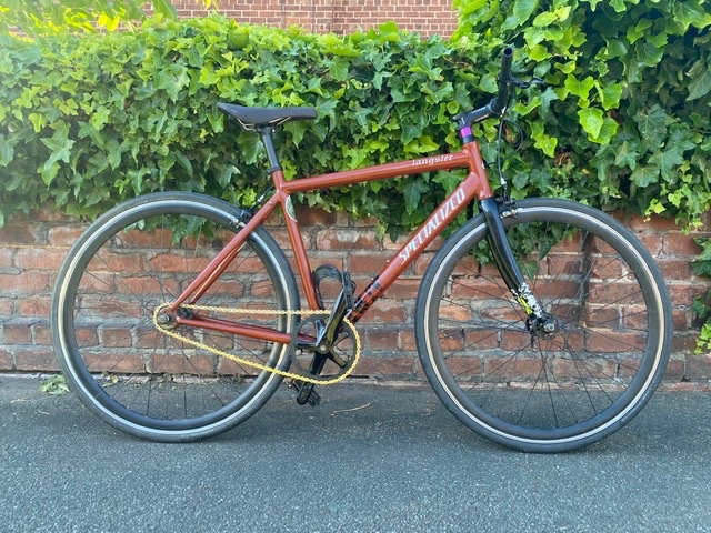

Rebuilding this up
Edit / I have no idea why that’s rotated :roll:
