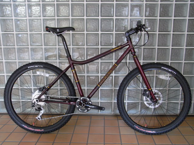

On a side note - anyone remember the Haro Beasley? I recall they were pretty much laughed out of the playground by other manufacturers because ... that's right, it had 650b wheels. I rode one, 'twas actually very nice. I don't remember thinking wow, these slightly bigger wheels are fantastic but I do remember thinking it rode well.
