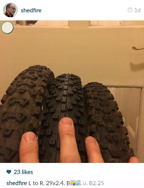

Tried a 2.4 ardent in both a slotted drop out frame and a vertical drop out frame, both on 24mm rims. Its fits but its tight (like 3mm clearance) and soon clogs with mud. A 2.25 is far better.
My Fargo actually has more clearance. Anyone after a large inbred frame?
Posts: 4012
Re: How wide can i go at the rear . . .
Shedfire Instagram
Shedfire Instagram
http://instagram.com/p/yp08pYL3U3/

on one say you can fit 2.4 but recommend 2.3 max, clogs up quick 2.25 was best
