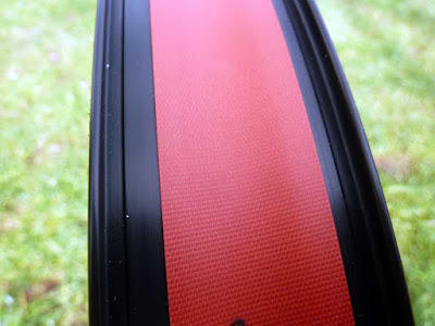

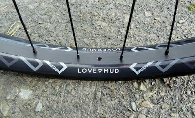

Lets start with the most obvious bit – the rims. Firstly, they’re 45mm inside to inside so will provide a stable platform for your larger than life tyres. They’re also tubeless compatible and have a very pronounced ‘bead well’, meaning your tyres should remain nice and secure even when pressures drop to ‘are you sure’ levels. They’re capped of with a nice anodised black finish and subtle Love Mud graphics.

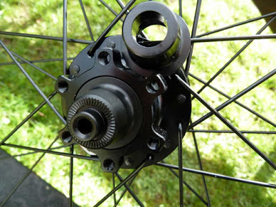

In these days of multiple standards, it’s important to future-proof yourself whenever possible and the Love Mud hubs allow you to do that. These can be converted between 100mm QR and 100mm 15mm front and 135mm QR and 142mm rear with a simple change of included end caps, it’s not ‘tool free’ but requires no more than two minutes, a cone spanner and an allen key. As you might expect, the aluminium axle spins on sealed cartridge bearings as does the aluminium freehub body. There’s six pawls living in there too, which should help keep things ticking along nicely and transfer all that awesome power your legs develop to where it’s most use.
Joining the hubs to the rims are 32 plain gauge, black stainless spokes accompanied by brass nipples. Straight out of the box, they’re true, tight and evenly tensioned … which surprisingly, isn’t something you can say about all pre-built wheels. Weights seem pretty reasonable with the front weighing 1238g and the rear 1342g.
