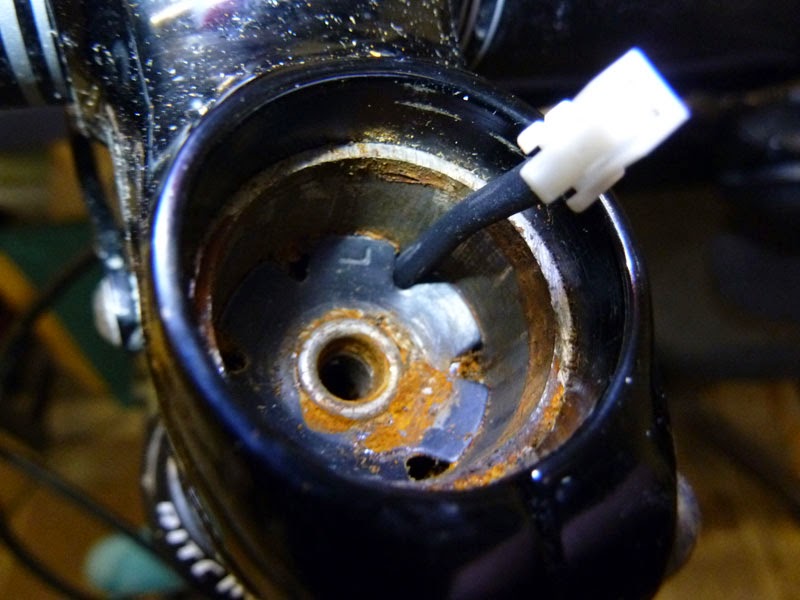

I’m glad to say, that there’s nothing particularly difficult about fitting the unit. The feed wire from the dynamo runs up the fork leg, through the steerer tube and finally exits through the star fangled nut. The supplied wire is pretty thin, so the first thing I did after cutting the wire to the right length was heat-shrink it. I’m sure this isn’t really necessary but I thought it wouldn’t do any harm, especially where the wire runs through the star-fangled nut.

The other end of the wire comes with a connector pre-fitted, so aside from a smear of Vaseline to help keep any moisture at bay, there’s nothing to do except connect it to the unit. A new stem-cap bolt is supplied and I’d suggest you use it, it has a clear plastic sleeve on the threads nearest the head. The outside of the sleeve’s a tight fit against the inside of the unit and forms a seal … don’t go thinking it’s not important and taking it off, make sure it’s there.
All fitted and ready to go.
With all the wires securely attached in their appropriate locations, the unit just bolts in place like a regular stem cap. I positioned this one so the USB port faces the rear of the bike but you could fit it anyway you like … unless your mechanical prowess starts and ends with shoe laces, it should take you around 20 minutes to wire and fit.
